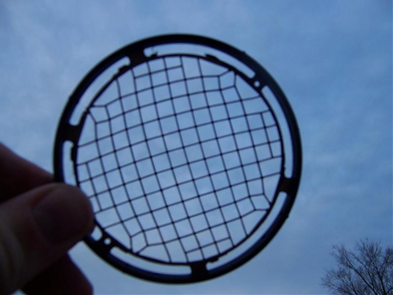

What is this screen for behind the throttle body? BTW this weekends project for me will be a throttle body port and polish.

The main runner almost makes a U-turn after the throttle body before it splits into the 6 single runners. Remember thier is also a variable intake runner plate somewhere inside this too. So the fuel will already have to turn and get past the plate. Really the pics I have don't do justice for whats actually seen in person. I'm actually worried about that screen catching most of the fuel on it.
