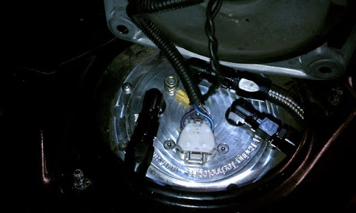

I know most you guys are trying to fix the gauge problem in your current installs, but for anyone reading this thread that hasn't gone for a swap or na-t yet, I just used with the swift racing pump hanger to eliminate any potential issues, it is a bit pricey but it takes care of all 3 of the major fuel assembly issues. It gives you a return feed, it keeps the siphon working for the other side of the fuel tank, and my gas gauge also works properly. Another plus is of course allowing a second pump to be used if you need two.
The only 2 downsides with this unit is of course, the price and you can't use the denso supra pumps because they are too big in diameter and everyone seems to love those pumps. If I ever have an issue with these Walbro 255's I will give the DeatschWerks 300's a try since they are the same size. But so far so good with the Walbro's..
