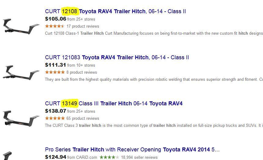

When i do a "2014 RAV4 Trailer Hitch" search... I also get CURT 13149.
CURT 12108 is a Class-II hitch - 300 lbs tongue weight - 3500 lbs towing - 1 1/4" coupler ($105 on Amazon Prime)
CURT 13149 is a Class-III hitch - 525lbs tongue weight - 3500 lbs towing - 2' coupler ($139 on Amazon Prime)
based on jalford's 12108 install, the 13149 should fit as well. (this is all speculation!) seeing as I want it for tongue weight for a trailer hitch storage shelf that has a 2 inch insert, the 13149 would do better or me...
