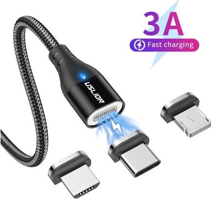

I see. So the problem lies with Apple not Lexus... Too bad nothing can be done about it besides switching to a different phone, that must be very frustrating!
May I suggest using a magnetic break away connector on your phone? I have some for my Android (Type C) and I believe they also exist for apple. A small portion of the plug remains permanently in the phone connector and only protrudes very little. The remainder of the connector and cable connect by simply approaching one to the other through magnetic contacts (like the Apple power cord for MacBooks and likely other Apple products). That way you can connect very quickly to your power cable in the car as it magnetically snaps, you don't have to insert and remove each time. Not as nice a wireless but pretty close... and very reliable.
