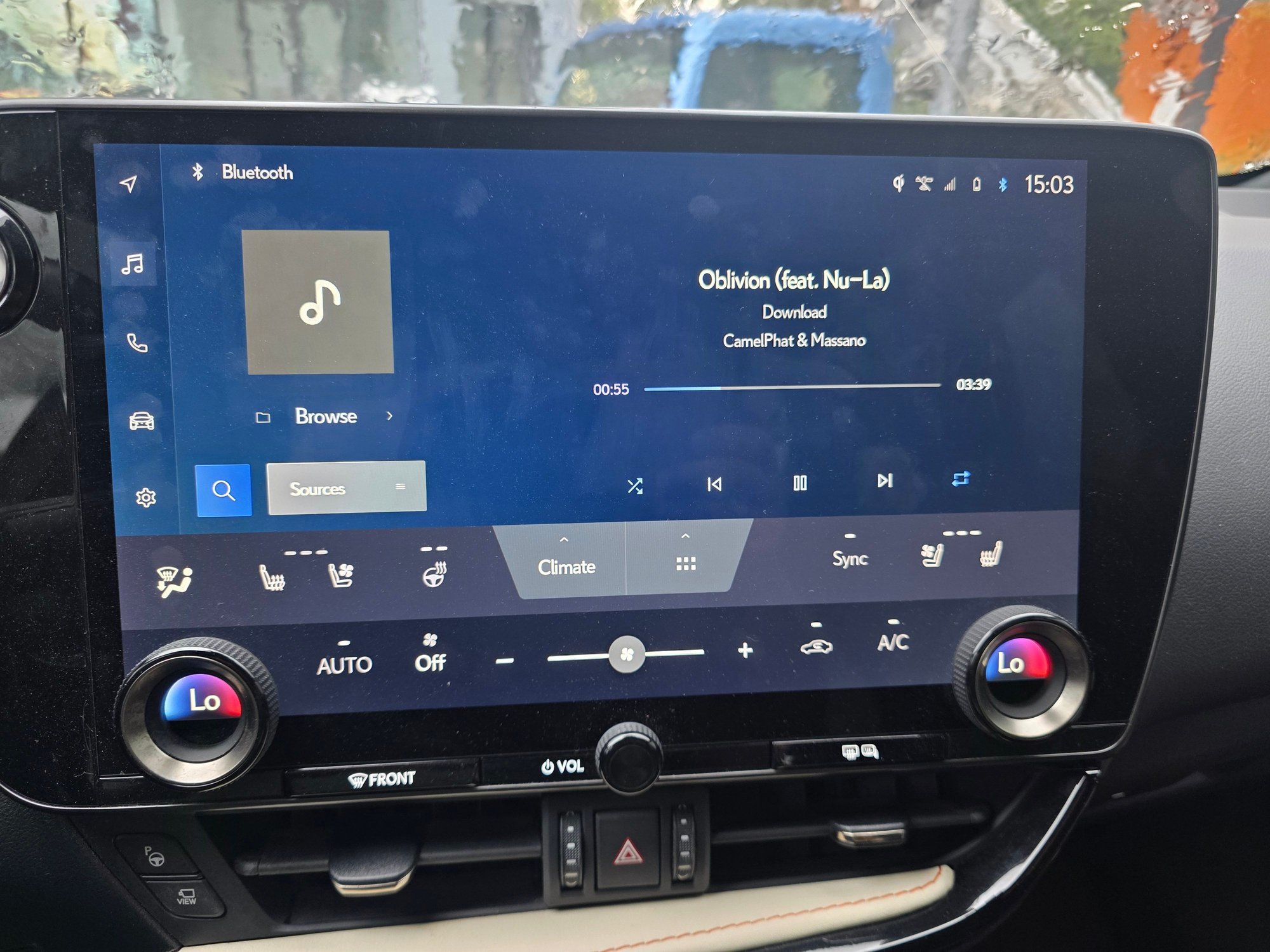

So here A/C is off,temp settings on Low, should be ac compressor still on?bc i notice condensate dripping down to road.which are temp ranges where heating system and cooling system will be off?just to get ambient temp in and save fuel.

I have read already about climate control and there is no answer about it.just that it has S flow,max cool,max heat and eco mode.(also there is one zone and dual zone control system).
so u need to know ambient temp and set the climate control accordingly for not to engage ac or heater.

I have played around also with just trying to get outside air into the car without necessarily using the A/C and my understanding is that if you hit the A/C marker so that the bar above turns GREY the compressor is not on. I could be wrong but when I have done this the air coming out definitely is not as cold as when the compressor is on.

actually it is on.if u let it idle,come out from the car and look down,there will be water(condensate)coming out.it is not as strong as when ac button is on.it is climate control,tries to achieve temp in the cabin u choose

As others have suggested, touching the A/C button until it turns grey turns the compressor off...at least as far as I can tell.
I've been turning the compressor off before parking my cars for UMPTEEN years. Always do it at least one minute before I'll be shutting down the engine. That way condensate does not sit in the system and develop STINKY mold.
Another way to shut off the compressor is initiate the "HEY, LEXUS" deal and say "TURN OFF A-C."

A simple trick I've used to force or make the car think to not turn on the compressor, is to confirm your outside temperature, so if you're just starting out sometimes the temp is off a bit from the sun warming it up. So after you've driven around for a bit you see outside temp is 70 degrees, if you set temp in car to 71 it shouldn't activate the compressor. I can't confirm, but it makes sense, as long as you don't have defrost on.
