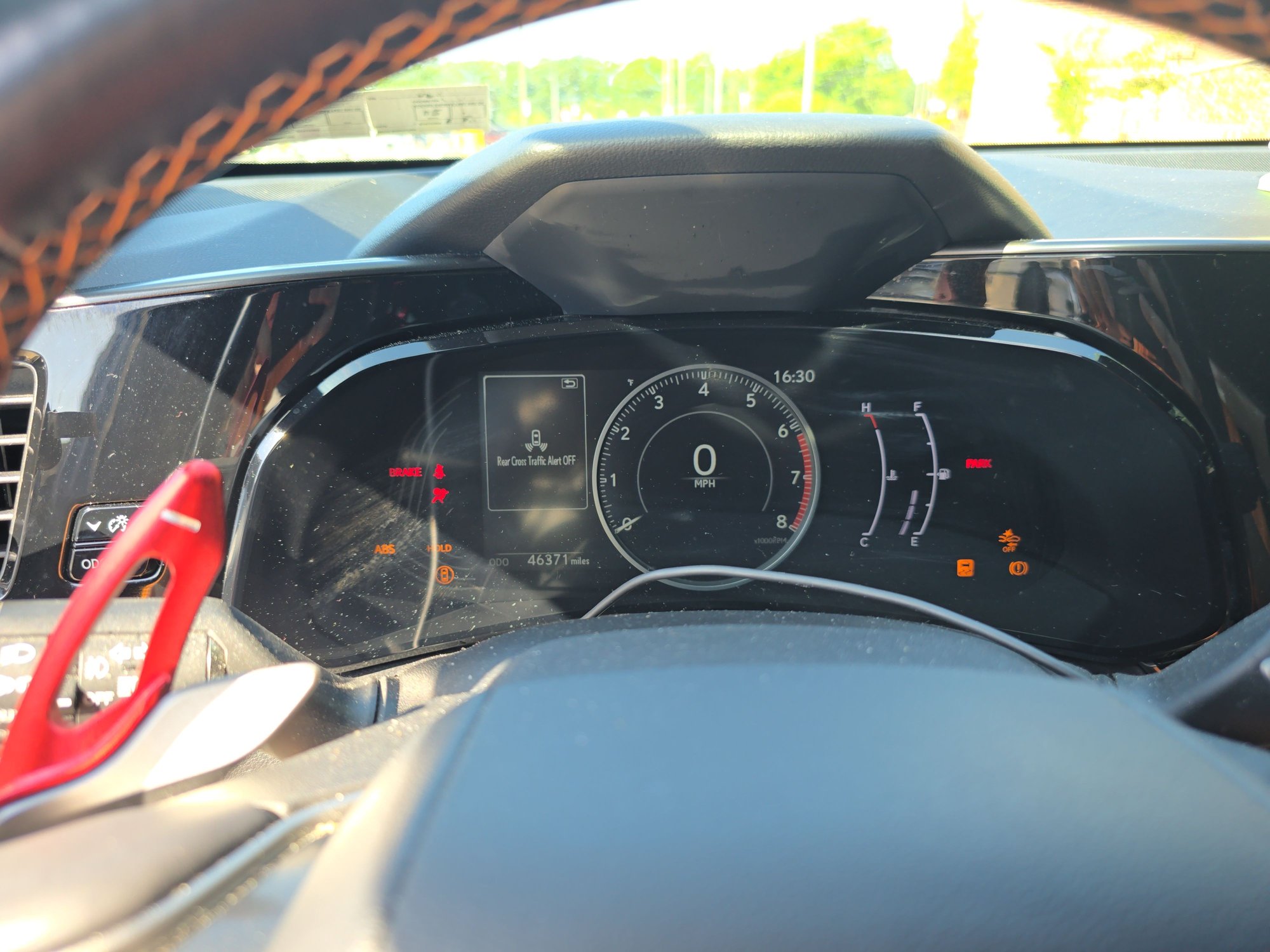

Default NX 350 malfunction
Hello. So since 6/24/2025 I started up my car and all these malfunction show up. Vehicle is been toll back to the dealership. They tested sensor were good, hardness were good, they even swapped out the start&stop ecu this Wednesday(7/16/2025)but nothing resolve the problem. Check engine light was on recently so is the airbag. They kept telling me theres NOTHING wrong with my car. Clearly there is something wrong with it. Does any one know what can cause this issue? They also tested the 12V and it was fine.
Its a 2022 NX350 running at 46k miles. Brought the car brand new and 0 accident.

It looks to me like you drained your 12V battery or it got really low. So if that is the case, then it is indeed nothing wrong with the car, you just need to clear all the error codes and charge up your battery really good and you would be good to go.

They tested the 12V and told me it was fine. I have nothing hook up to my car beside a radar detector and a dash cam. They charge up my battery the night after the car was dropped off, all those lights went off but after 5 mins it all comes back. I've ask them to test the 12V but they insist that they did.

I thought about the 12 volt battery too but he’s indicated it was checked. I also would suggest a low 12 volt battery will throw up all kinds of codes. I really think the techs are suspect in their lack of diagnostic abilities.

The 12V is the first thing it came to my mind. And ive let them know alreadyalready beginning. Because as I know of low 12V or a nearly dead 12V can cause the whole car system to crash down.

Was it parked outside? Any rodents got into the electrical system or have dropping in the engine compartment?
If no rodent issues, it could be many other things.
I pulled this on the internet:
Possible Causes:
  • Low Voltage/Charging System Problems:
    A failing alternator, a weak battery, or a problem with the charging system can cause the voltage to drop, affecting multiple systems and triggering the warning lights.
  • Electrical System Faults:
    Issues with wiring, sensors, or other electrical components can disrupt communication between different modules, leading to warning lights.
  • Faulty Sensors:
    A malfunctioning sensor, such as those in the ABS system or airbag system, could send incorrect signals, causing other lights to illuminate as well.
  • Multiple System Malfunctions:
    In some cases, a single root cause can trigger multiple warning lights. For example, a faulty wheel speed sensor could affect the ABS, traction control, and even the engine management system.
  • Software Glitches:
    In rare instances, software glitches within the vehicle's control modules could cause false alarms.
Save all your documents and each attempt to fix it. Definitely engage Lexus Corp. (800) 255-3987.
Close to warranty expiration so keep good documentation.
If so many tries it can't be fixed, it's a lemon and you may need a lemon lawyer maybe.
