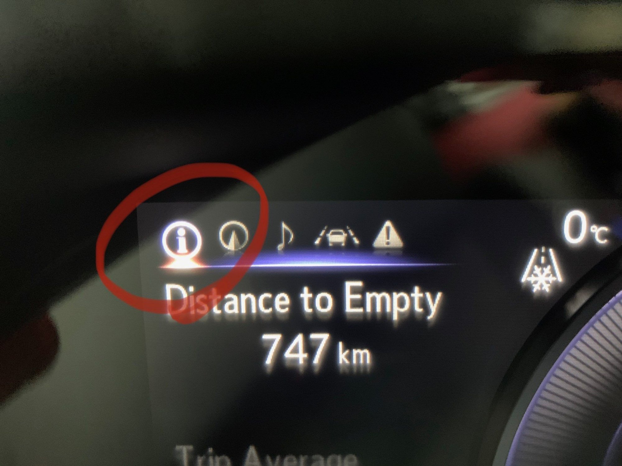

I see this icon lit up on the dash. All I’ve gathered so far is its an information light.. Ive been trying to find out what it means in the manual or to escape out of it, if it’s just hi listed because it’s where it is sitting. Any help appreciated

This is not a warning icon. The i icon is just highlighted when you have the trip information screens selected to view in your display, ie its simply telling you that you're currently viewing the trip screens which show (depending on model) distance to empty, current and trip fuel economy, g-force gauge, turbo meter, gear position, eco meter, etc. The 5 icons in a line starting with this icon indicate the 5 groups of information screens you can select (trip info, nav, audio, driver assist, alert msgs), using the left/right arrow keys. Within each group, some of them have multiple screens that can be selected by the up and down arrow keys (as I listed some in the trip screens above).

For some reason I dont remember those icons on the dash. Had me worried
I appreciate the reply.
