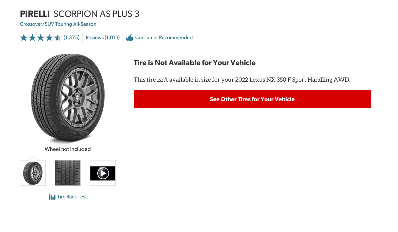

Tire Rack has the Michelin Cross Climate and Pirelli Scorpion AS3 as the top rated. I have the Pirelli's on my RX and love them quiet and a smooth ride. The Michelin's supposely not as good in mpg but better traction in snow.
Weird. This is the message I got from Tire Rack when I tried to get them.

That's because you have to change your tire size.
Pirelli Scorpion All Season Plus 3 245/50R20 102V

That would be correct, The 235/50 20 is an odd size, not many company's make them. I put 1,100 miles on the run flats and could not take the road noise, harsh ride and poor handling any more. I put on the tire you have listed but went to 245/50 20s in January, they ride great, have very little road noise and handle much better than the 235s. No problem mounting the 245s on the NX 20" wheels, just a slight difference in speed O reading. I ordered mine from Amazon (best price) and had a local independent shop mount and balance them. When I get rid of the NX (which won't be long) I'll put the run flats on.

Just put the OEM size in the first set of blocks 235/50/20 and the different size 245/50/20 in the second set of blocks and you can see what the differences are. Extremely minimal and well within the allowed tolerances.

So right now I have 235/50r/20, you’re saying just replace them with 245/50/20 and it’s fine. No issues? Just speed off a tick.

YES, it's that simple. I swapped my RFT's out to the Pirelli's above at 2,800 miles based on @43sbest suggestion. I'm glad I did. I hated the RFT's.
