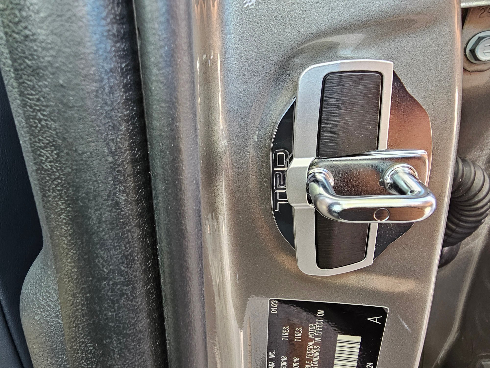

Installed TRD Door Stabilizers on my NX and the difference is dramatic. The car handles really well when making turns. I don't feel the car body flexing like it did before installing these.
Part number is MS304-00001 and you need to buy 2 sets of them for both front and rear doors. As a bonus, I also installed the JDM reflector buttons (part 81580-V1040) for the front doors. A simple $1 upgrade, but you need to get them from Japan.

dramatic difference huh. it takes a lot of force to flex a unibody -- about 20,000 lbs of force to twist a super tiny amount. amazing you could feel that flex while turning

Maybe I'm not describing it correctly, but the car handles and feels much better while turning. I was skeptical at first myself, but I'm glad I took the plunge.
If I felt it was a waste of $250, I would have no problem telling all of you to skip this mod.

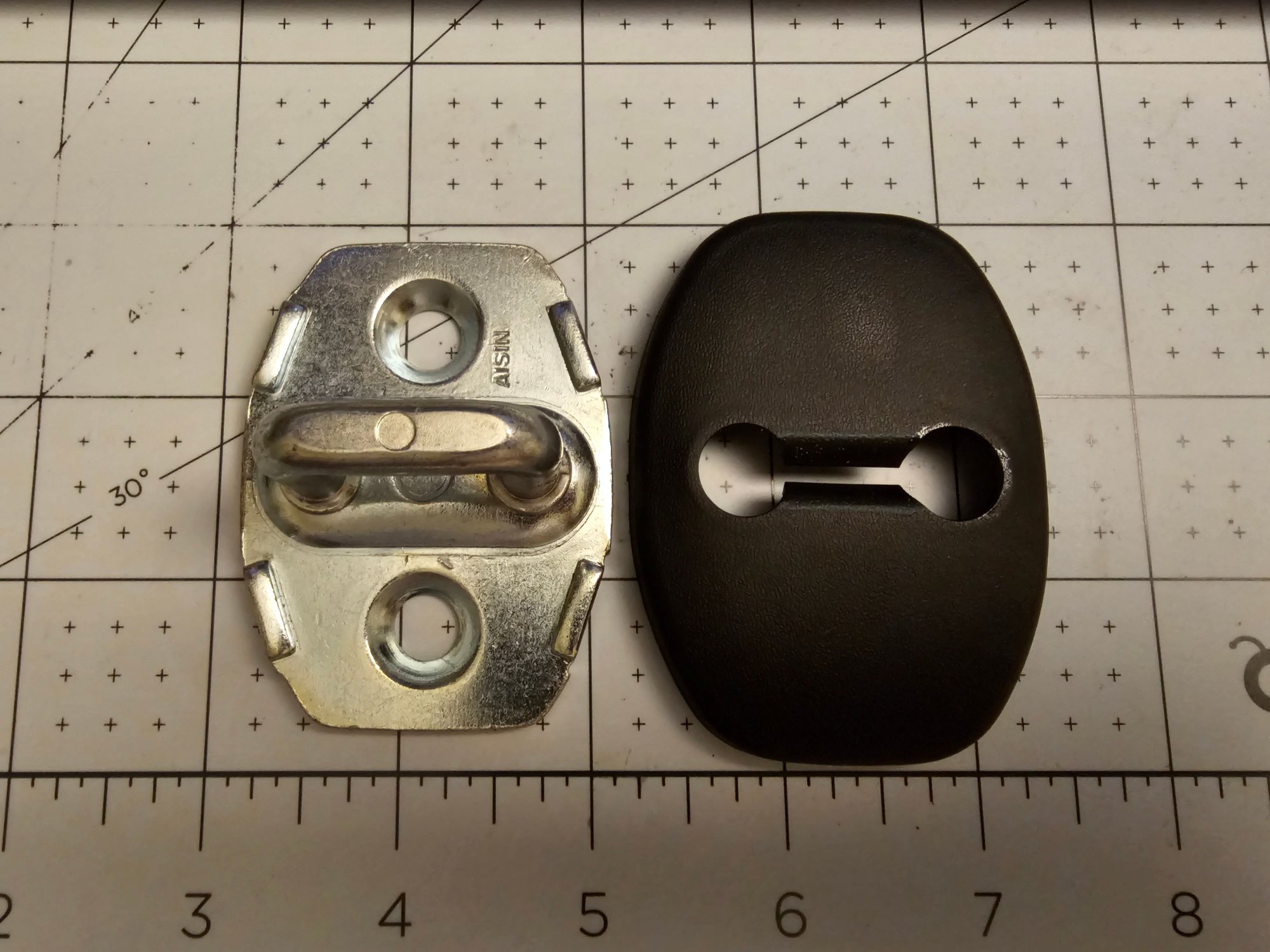

Watch this Japanese installation video. Everything is pretty straightforward. He shows you around the 5 minute mark how it works. The sliding mechanism will adjust to your door closing, giving you more body rigidity. You need a T40 torx for the door loops and a T30 for the bracket.
Attached photo is the OEM door loop made by AISIN. This door stabilizer kit gives you a new door loop with spring loaded slider, and a bracket for the door.​​​​​​
The yen is really weak against the dollar right now, so if you have a credit card with no foreign transaction fees, I would pay in JPY on Amazon.jp. It comes out to $213 USD shipped for two pairs of the door stabilizers. If you use ebay or Amazon US, you'd be paying $280+. All of those Amazon US sellers are just shipping from Japan anyway.
