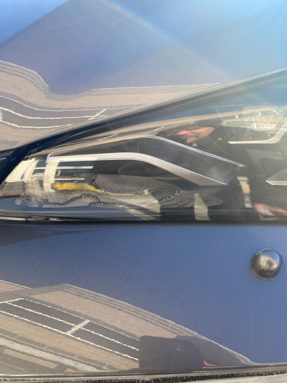

My 2018 NX started to develop a water leak last summer, initial visit to dealer resulted in a wasted trip since nothing was seen due to it drying up after a few days. They told me take photos so next time they could justify any warranty work.
Finally took it in with a bunch of photos from both sides during multiple incidents, which always was after driving highway speed during a rainstorm.
After removing the bumper and noticing cracks in both assemblies, not caused by any obvious collision or external damage, dealer agreed it’s a defect.
Waiting till parts come in from Japan, about $4,000 Canadian for both headlamps. Covered by 4 year warranty.

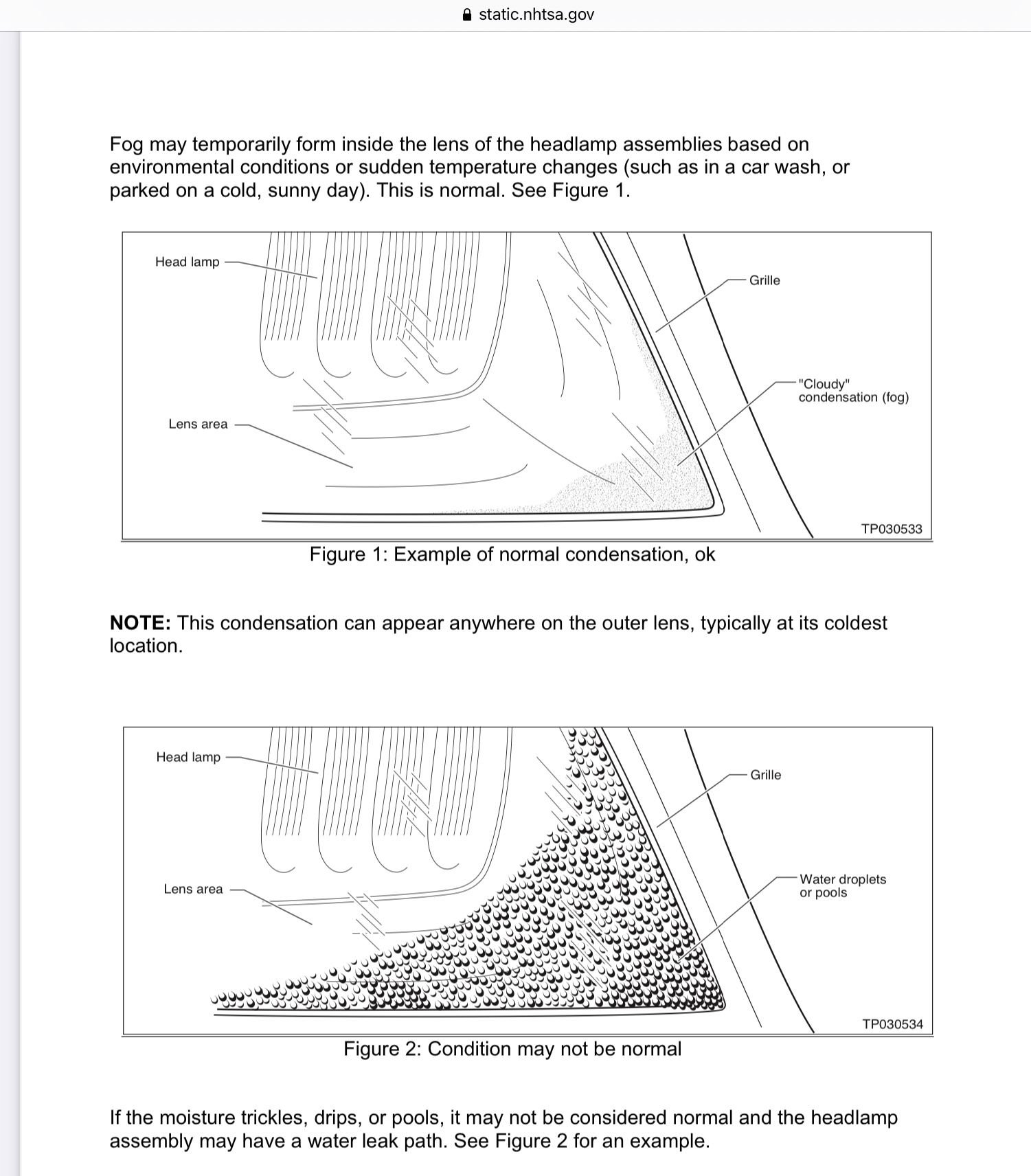

From Nissan document, I think it best explains the difference between condensation and leak.
Photo of my leak which dealer accepted as proof.

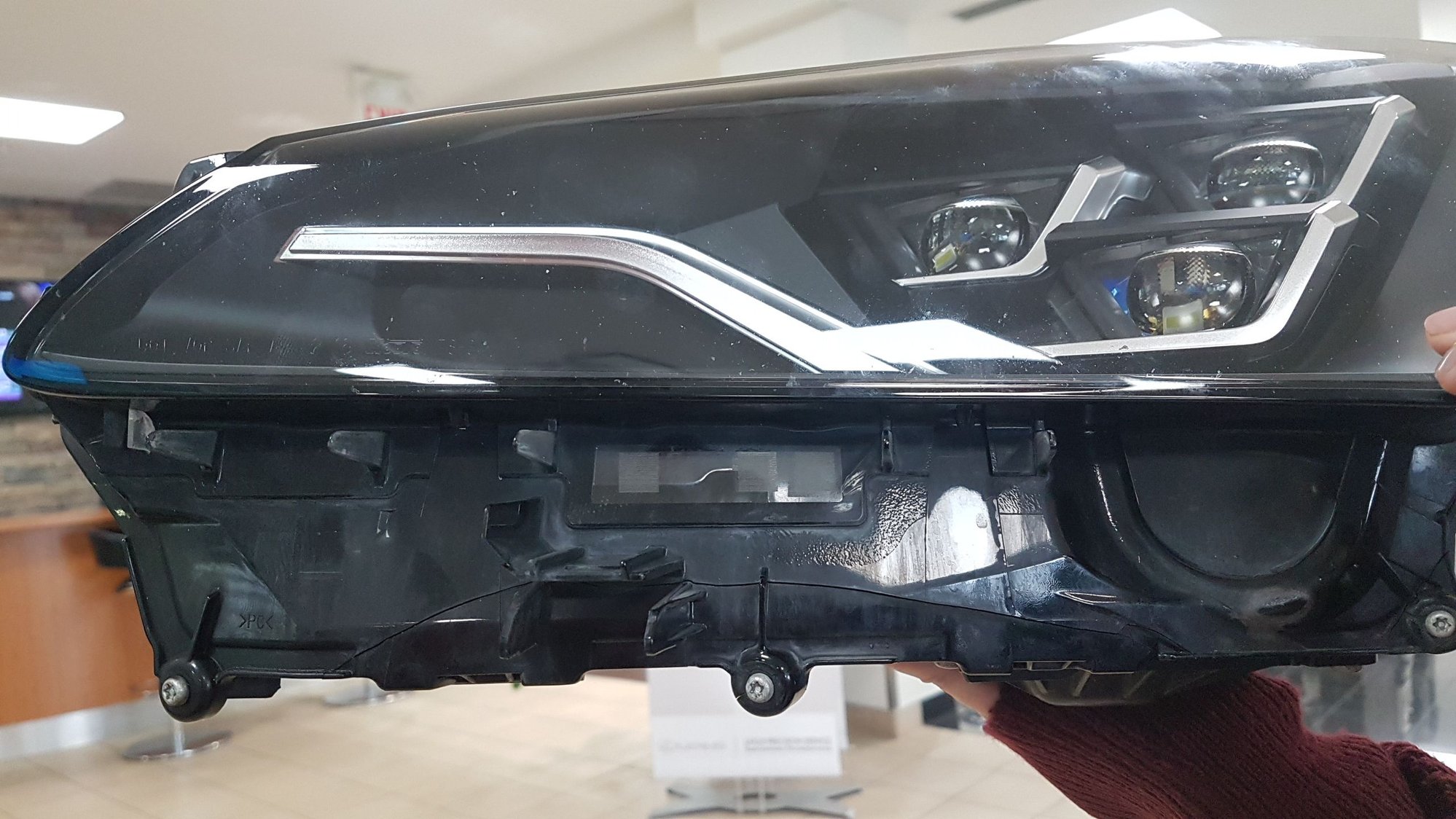

Got replaced both under warranty. They both cracked.
