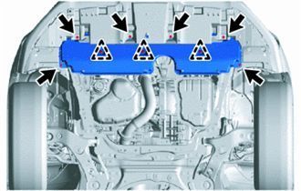

My car has not been running since the lockdown due to covid. Today I opened the hood and took the battery into my house to charge it. And it all started here, I stupidly locked the car and closed the hood completely, my car was completely locked. I calm down and get the key manually and I can't open the driver's door again, I tried both with 2 mechanical keys, it seems the mechanical door key is faulty. Someone help me, I saw on youtube a few people jump with the positive terminal of the starter, and the car has electricity they can unlock with the remote normally. Help me

Starter is below the battery and removed from the top after removing the battery, battery tray, and reinforcing bracket. I cannot see the positive cable when viewing from under the car with a mirror and light.
Another approach might be to remove the plastic cover under the radiator (2 screws, 4 bolts, and 3 plastic push-fasteners - see attached image).
If your arms are long but small, you can then reach up behind the radiator and operate the hood release. Alternatively, use a stick or long screwdriver.

I have had release cables break, resulting in a need to open the hood from below. But fortunately, not (yet) on the NX.
Since it appears this may become the "prime option" in your case, I studied the mechanism more carefully.
Most important. there is an error in my previous drawing. I had incorrectly identified the moveable part located below the spring. See corrected version attached to this post.
I do not think any adult will be able to do this by hand. There is ~18 inches between the mechanism and the lower plastic cover, and only ~2 inches of space front-to-rear. Few adults have an arm less than 2 inches in diameter. There are also some obstructions in the path, the most significant of which is a ~1 inch diameter coolant hose located just below the mechanism (dashed circle in the attached drawing).
The most practical approach appears to be a long (at least 18 inches) flat-blade screwdriver positioned at an angle to use the hose as a fulcrum. The hose is somewhat flexible and will deflect when force is applied, but I think it will retain enough rigidity to allow the release lever to be moved to the right a sufficient distance. I successfully did this (albeit from above) with a shorter screwdriver, but the hood was already open at the time, so less force was probably required.
A length of inexpensive 1/2 inch electrical conduit clamped to a shorter screwdriver (with 2 worm-gear band clamps) could also work if a long screwdriver is not available.

To (attempt to) answer your "Locksmith" question, I performed some experiments on my NX. The short answer appears to be NO; a locksmith cannot help you.
Why not? . . . it turns out the "mechanical key" is not mechanical in the traditional sense, it that it does not mechanically unlock the door. Instead, rotating it clockwise operates an electrical switch that powers the door actuator(s). So the mechanical key is useless with a dead battery. I proved this theory with the following experiment:
(1) With hood and drivers window open, I reached in and locked the doors. The "mechanical" key worked as described above to unlock them.
(2) Next I removed the "Door Lock #1" fuse (20A; located in the under-hood relay/fuse box). Rotating the "mechanical" key now had no effect whatsoever. In my view, this is a silly and ineffective design by Toyota/Lexus, and not clearly disclosed in the Owners Manual.
Reviewing the wiring diagrams, I noticed Lexus includes an optional door lock backup battery in some markets, mounted in the center console. This allows the door locks to still operate even with a dead or disconnected main battery. Unfortunately, this useful feature is not included in NX300 models offered for sale in the USA (or probably Canada). I do not know if the hybrid model includes it.
After raising each front tire with the jack, I recommend to lower it back onto something solid like one or more concrete paving blocks or scrap boards. This is more secure than the jack itself, and will not obstruct the space you need to work within. Jack stands, if you have a pair, could be used as well.
