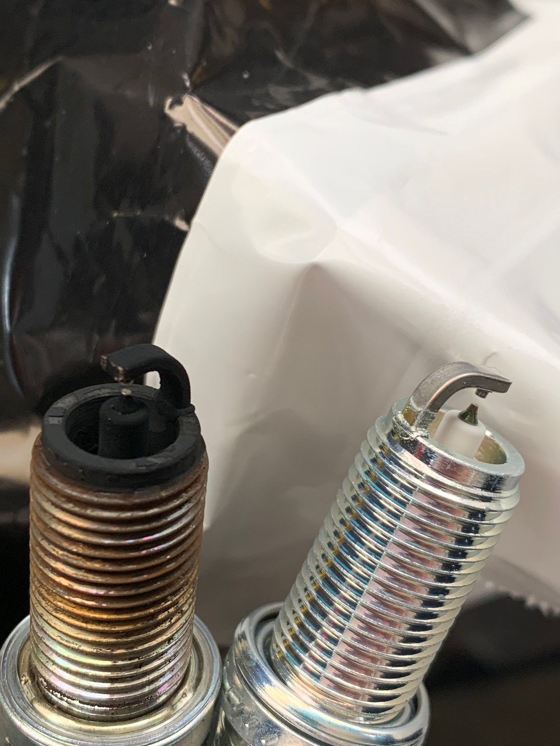

Hey guys, i’ve recently just changed the spark plugs and i was wondering if it’s normal to for it to be covered in black soot? They have 57,000km which is less than the recommended interval. Any ideas?

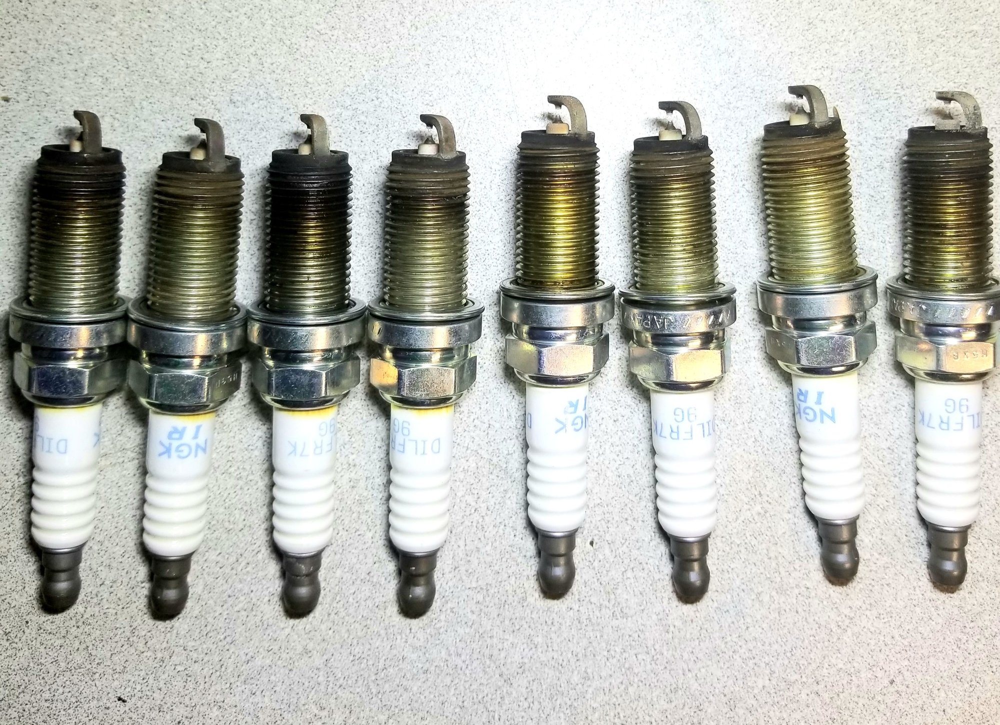

I recently changed the plugs on both my GS200t and NX200t. The plugs look like the below. They definitely are not as black at the ground strap or electrode tip. The GS is even tuned.
Do all plugs have a similar appearance? The vehicle may be running a bit rich or idled a lot. Are you seeing poor fuel economy or any other issue that made you change them before the interval?

Yes, all of them look the same. Fuel economy seemed to be normal, but i do notice that the car runs really rich during cold start. It is getting cold here and my commute is quite short so every time I start up the car it goes through that cold start cycle. Also, what tune do you have? I’ve done some searching and JB4 seems to be one of the few. I do have a BMS intake installed as well

Check if any vacuum hoses are loose or damaged. Unmetered air in the system can cause the vehicle to run rich.
