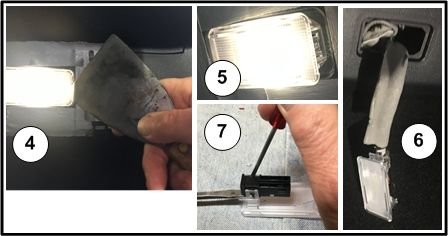

REMOVE THE CARGO LIGHT ASSEMBLIES
Look at the light assemblies while turned on. The left side of both should be noticeably darker than the right, because that is where the connector is located. The assembly must be pried out from the edge opposite the connector (usually the right edge).
(4) If interior temperature of the vehicle is less than 75F, warm the lamp assembly with a hair dryer, set on Low, to make the plastic less brittle.
Assuming the darker region is to the left, push the putty knife into the lower right corner to create a small gap between the light assembly and the interior trim panel. I first applied duct tape to the panel surrounding the lens to protect it, but this precaution is not essential.
(5) Insert the trim removal tool into the gap and work up and down to gradually pry out the right edge of the lamp assembly.
(6) Next, slide the assembly to the right and withdraw it completely. Use a small screwdriver to push the release tab at the rear of the connector (vehicle end), and separate it from the lamp assembly.
(7) To separate the LED module from the lens, first warm the parts with the hair dryer, then slide a medium size screwdriver under the LED module to push it
upward while using the small screwdriver to pry the clear plastic retainer clips on each side outward.
