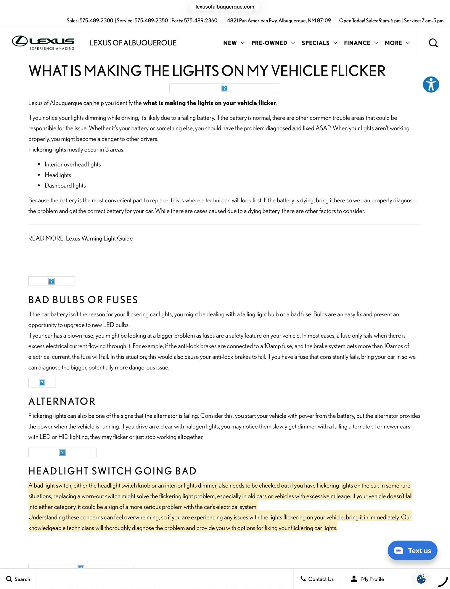

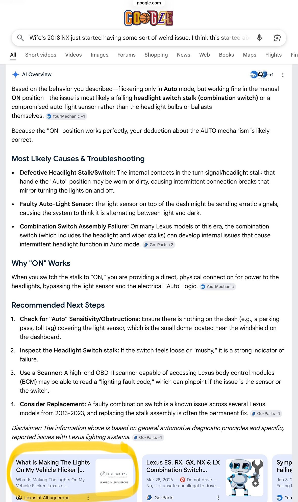

This is a very interesting dilemma, so I copied and pasted your whole text and below came up — see first pic.
Sounds like you thought of every possible option to help resolve the issue.
I noticed at bottom of first pic a link (circled in yellow) and clicked on that and saw the yellow highlighted portion at bottom of second pic that also advises same as first pic.
Hopefully, someone will chime in that has or had same issue and how it was resolved or you’re able to resolve on your own.
Either way, please update this post on what happens / happened next and if you were able to fix the issue.
