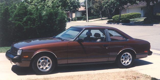

That's a nice well maintained Corolla!
One of the Toyota parts guys has a similar '80 Celica notchback. His hybrid 20R/22R ported-polished and OS valved head along with to other engine word was putting out 196HP at the wheels with the dual Mikuni's. Not particularly fast at 13's but compared to stock, that's quick. He has the Webers on it because the Mikunis are to much $ and he doesn't have some of the tuning parts he needs to run them. It will do 10 MPG in this build...ouch!
This is mine:

Love it. That generation of Celica angered the purists mostly in Japan they didn't like the styling at all. Hybrid R engines are amazing I know a guy that has one in an '87 pickup that sucker rips, no traction at all it's 2WD.
