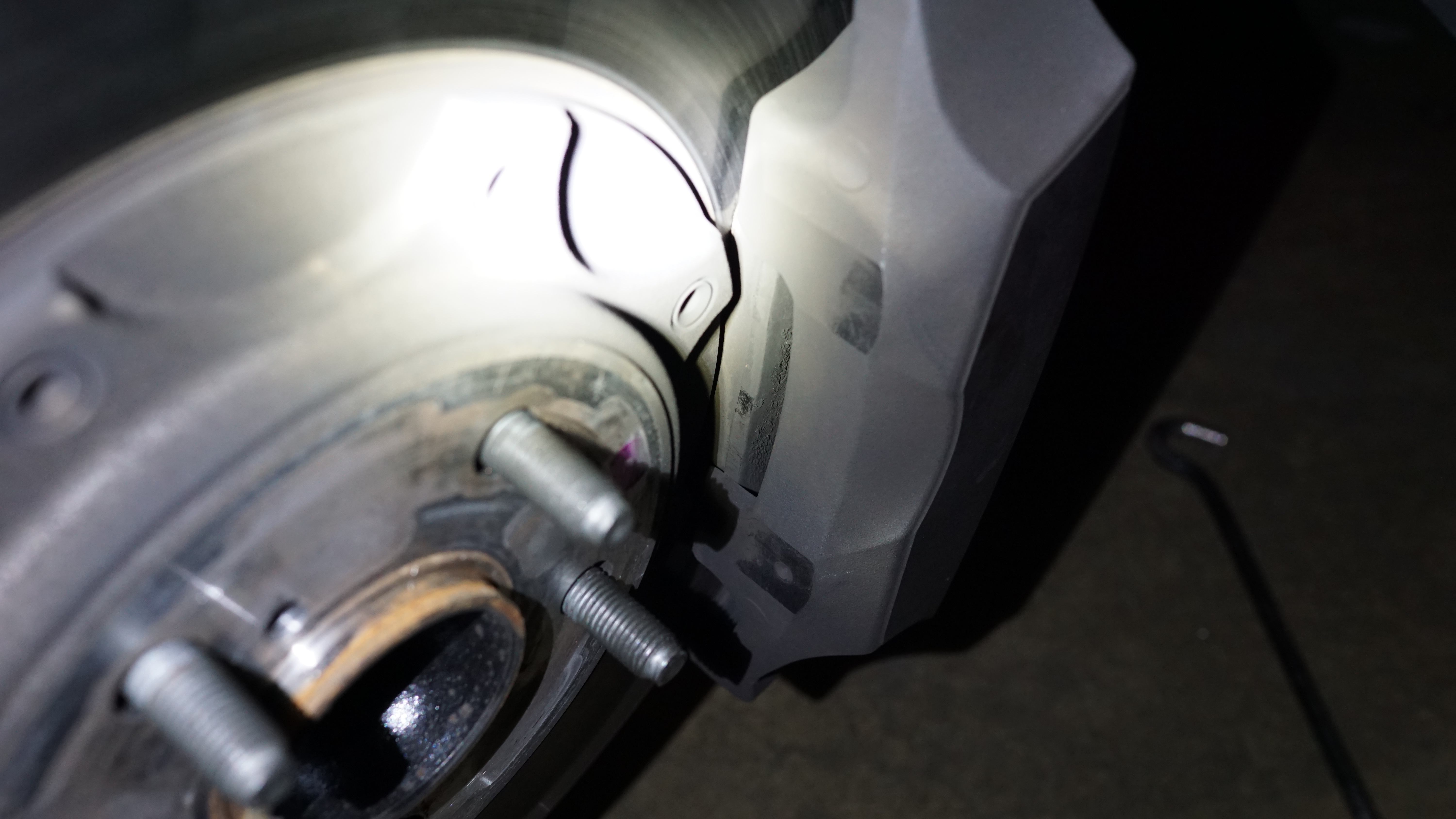

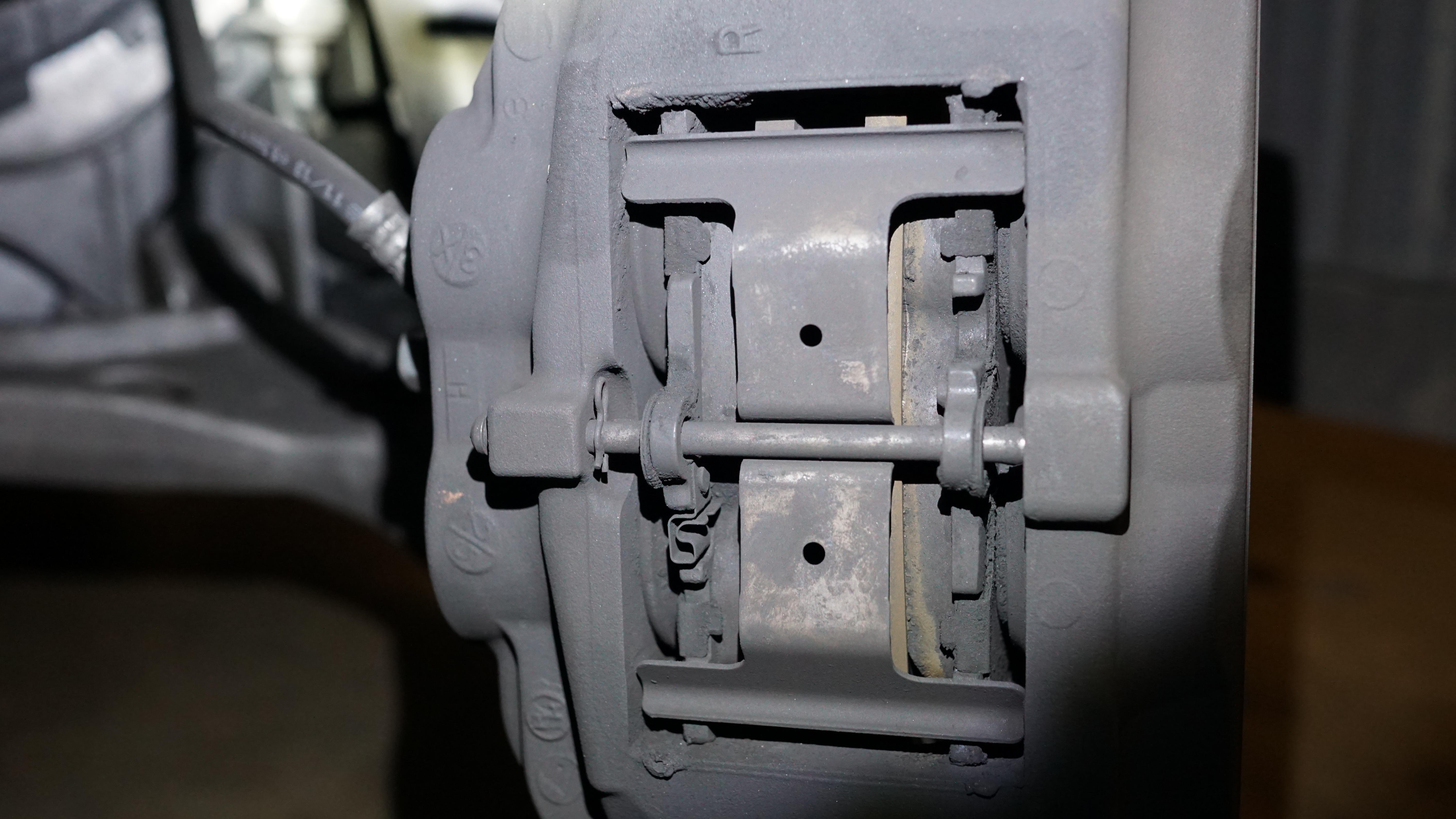

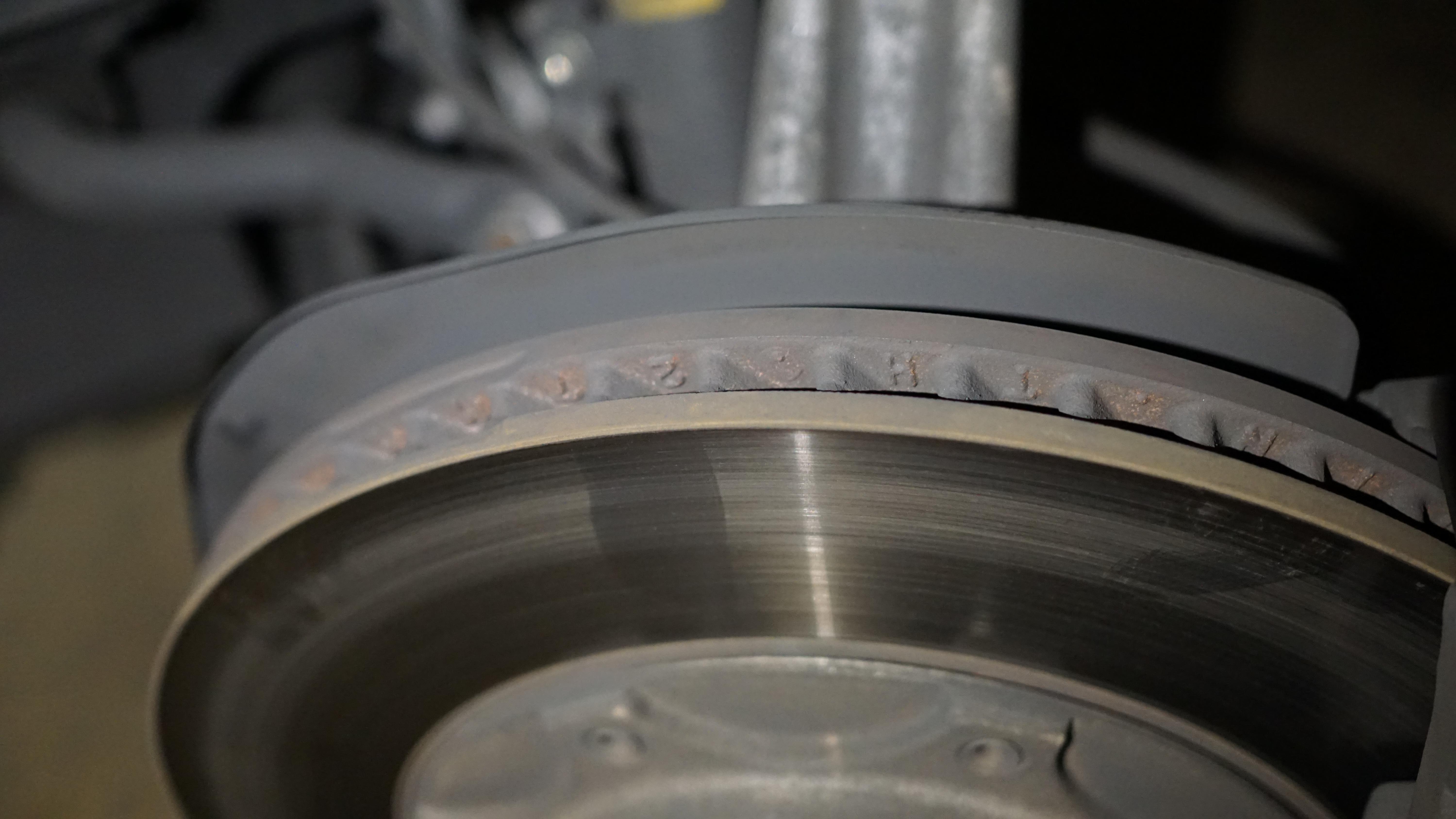

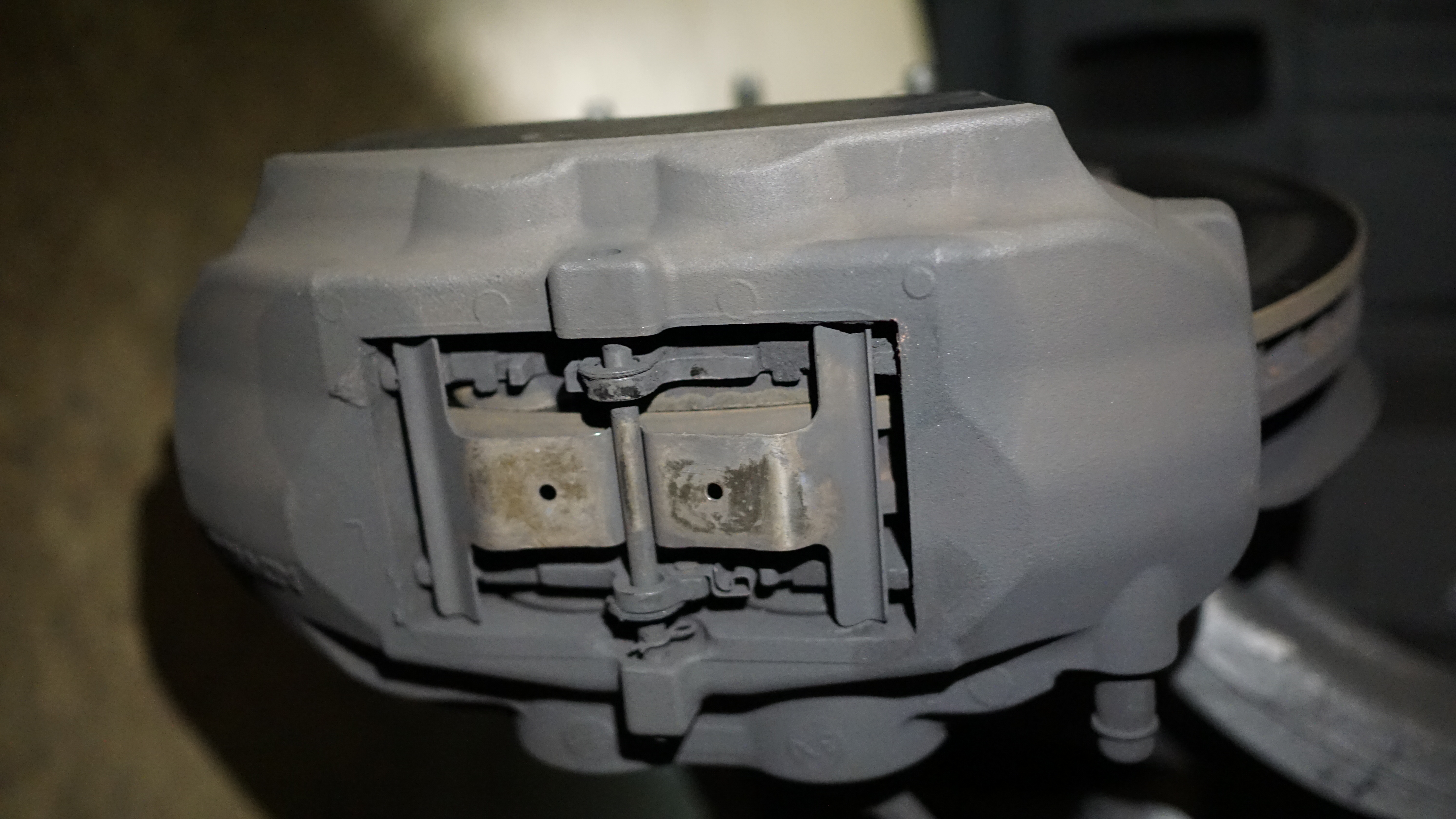

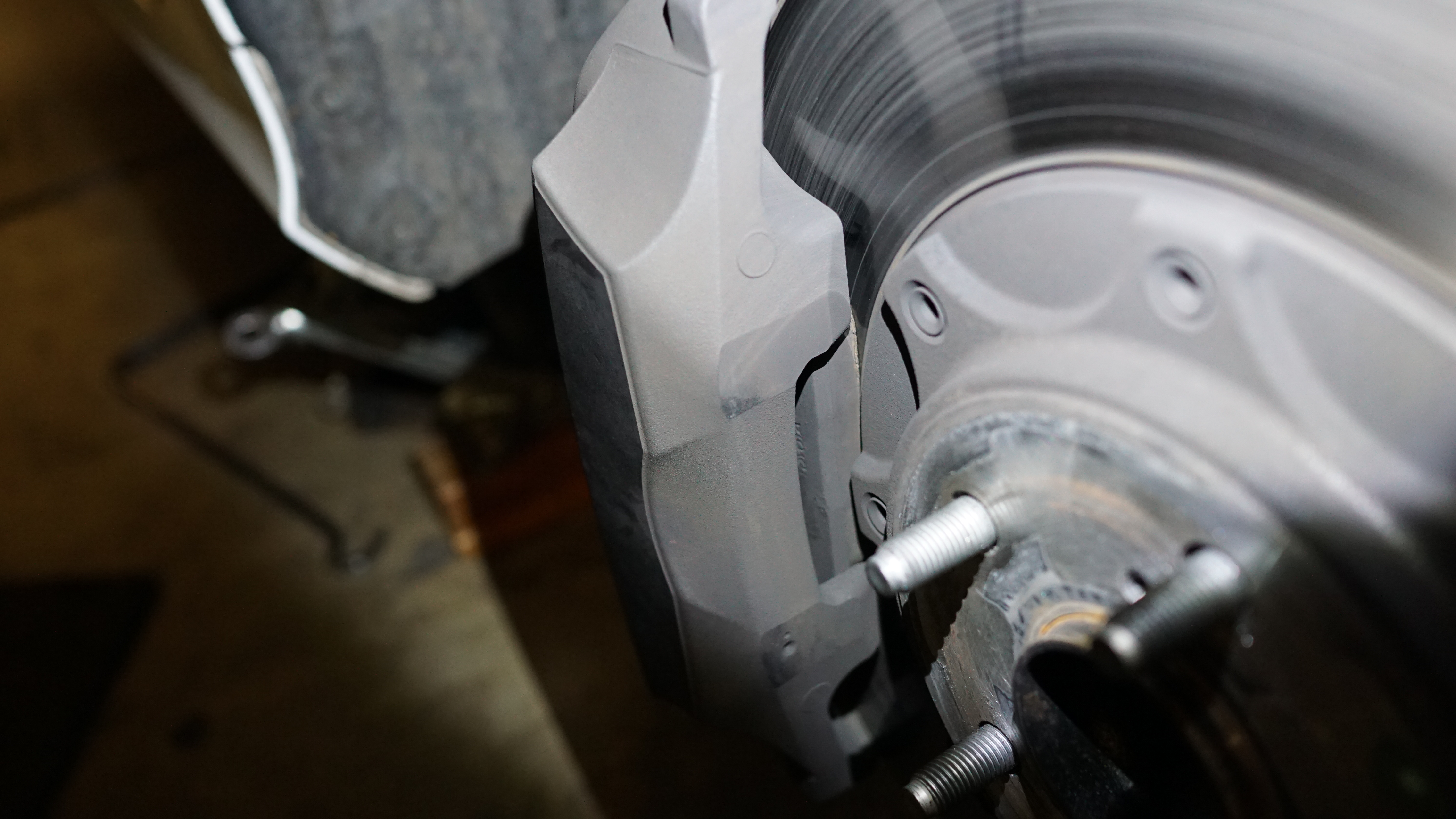

Hello,
By looking at these pictures, can anyone tell whether brake rotors were machined and brake pads replaced around 2-3 months ago?
I think I was cheated and no job was done.

It seems to me that you were cheated, I don't see any caliper pins with lube on them, plus it's hard to tell if the rotors were turned. My guess is they were not.

Pads seem new.
Hard to tell if rotors have been machined. But the price of rotors have came down quite a bit. I wouldn't machine rotors....just replace.

Pad looks changed. Run your fingers from the brake surface all the way to the outside edge. Is there a lip/bump at the end? If there is, then the disc hasn't been resurfaced. Resurfacing would have taken out the lip and you wouldn't have it again until the rotors wore down (definitely not within 3500 miles).
Yes, there is a bump at the end. What is the thickness of a brand new rotor in mm for GS F Sport?

I'd be happy with those. The pad looks thick, crisp, and even; and the rotor appears to have even contact.

looks like they did perform a brake job. You do not lube those pins the same way you do on free floating calipers. A little bit of toyota white grease works good but only on the spots that touch metal, so you would not be able to tell after 3.5k miles. the sound could be a bent backing plate, scratching on the rotor when the wheel is fully clocked 1 way. Easy mistake to be made while doing a rotate. thats only a thought tho. but yes it looks like you got a full brake job done.
