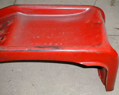

Here's a "pre-ramp" ramp, if your car is too low for regular ramps:
Here's what happens to your ramps when you overshoot them:
For more details, see this thread:
