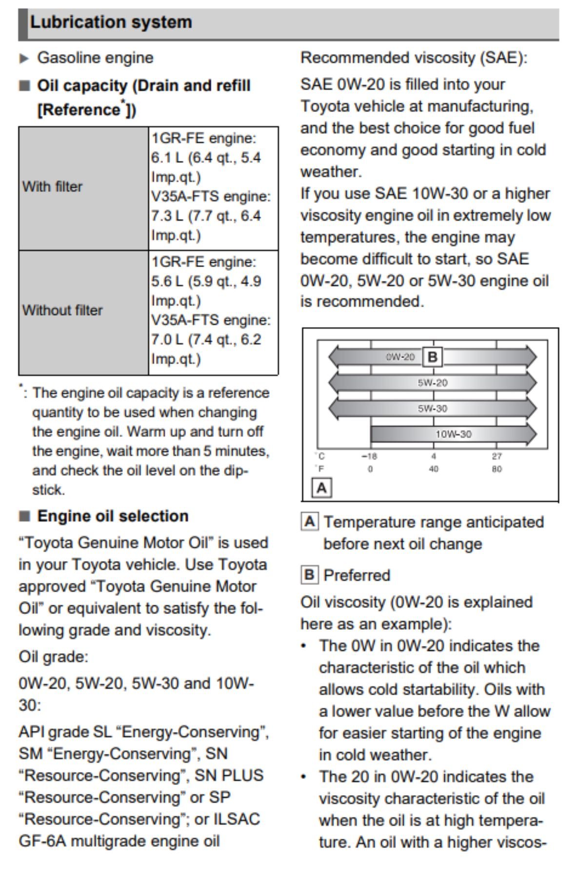

I switched to 5w-30 and it almost completely remedied my vibrations. If you live up north maybe 0w-30?
If you can DIY just drop the oil and it takes ~7 quarts. Walmart home delivery, 2 5 quart jugs of Mobile1 5w-30 guaranteed for 10,000 mile stuff. Like $50.
I am pretty convinced they are having some machining issues and the ones that vibrate or stutter need thicker oil.
I may even run 0W-40 or 5w-40.
Oh and I had to re-register as it wouldn’t let me reset my password…. Not like I am on here often. Similar name.
Here is the GCC manual if you don’t believe me:
Australian is similar but doesn’t list both engines, GCC is handy as it calls out the LX600 motor.
Going to do the transmission and Tcase to something less environmentally friendly as well soon.
Anything else yall want me to experiment with?

Yeah I am close by. I would change it a little early and not look back. If we are having the same issue it smooths it out quite a bit. It was driving me nuts.
I am posting all this up for reference. I started playing with ChatGPT on this.
There is three 30 weight oils in mobile 1 I looked at and the 0w-30 European Car Formula has more viscosity then the 5w-30 and 0w-30 Advanced Fuel Economy.
The additive package in the 0w-30 European formula is pretty stout but it doesn’t meet Toyota’s GF-6A spec (probably because its a better oil not focused on MPG). But that particular oil does meet API- SN Plus so it would meet the GCC manual required spec.
The 5w-30 does meet the US toyota spec though and thats what I am running.
Was researching it and I may even go to the European 0W-30 or 0w-40 next change. I am less concerned about the warranty.
I run the 0w-40 in a tuned 750hp Mercedes and it is great. Meeting Porsche A40, MB 229.5, and BMW LL-01 is as good as it gets and the 0w-40 gets you there.
