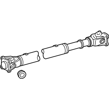

I have experienced this to some degree on my GX470, LX470, and LX570 vehicles. It typically occurs after braking to a stop, and is worse if the stop is rapid, causing the front end to "dive." At some point after stopping, the sensation is that the rear end drops. With the GX this was frequently accompanied by a noise llike a clunk.
My understanding is that all these vehicles have a slip joint in the rear propeller shaft assembly. The slip joint binds, due to lack of lubrication, or more rarely, a bent shaft. As the vehicle is braked, the propeller shaft slip joint expands or lengthens. As the vehicle settles after the stop, the shaft is supposed to shorten smoothly. If the slip joint binds, it releases quickly, and causes the rear end to drop quickly rather than smoothly. Sometimes this drop takes a while to happen; it may not come immediately after stopping, but seconds to minutes later. I have even had it delyed until I am driving off from the stop. Since I know what it is, I have chosen to just live with it.
The GX had a recall to replace the propeller shaft with a newly designed one, and it eliminated the problem for me. Greasing of this joint in my LXs eliminates the problem for a while, but it recurs. Sometimes within months, other times a year or more. It seems to depend more on mileage than time.
However, the OP has a new propeller shaft and this problem still is happening. Maybe the technician skipped the lubrication step. Or maybe the problem lies elsewhere. Just my 2 cents.

Both the 100 and 200 series have slip joints front and rear. Anecdotally, I grease the u-joints and slip joints both front and rear with each oil change, that's twice a year or about 5-6000 milord.. I've never had an issue with bind, let alone a bent shaft.
