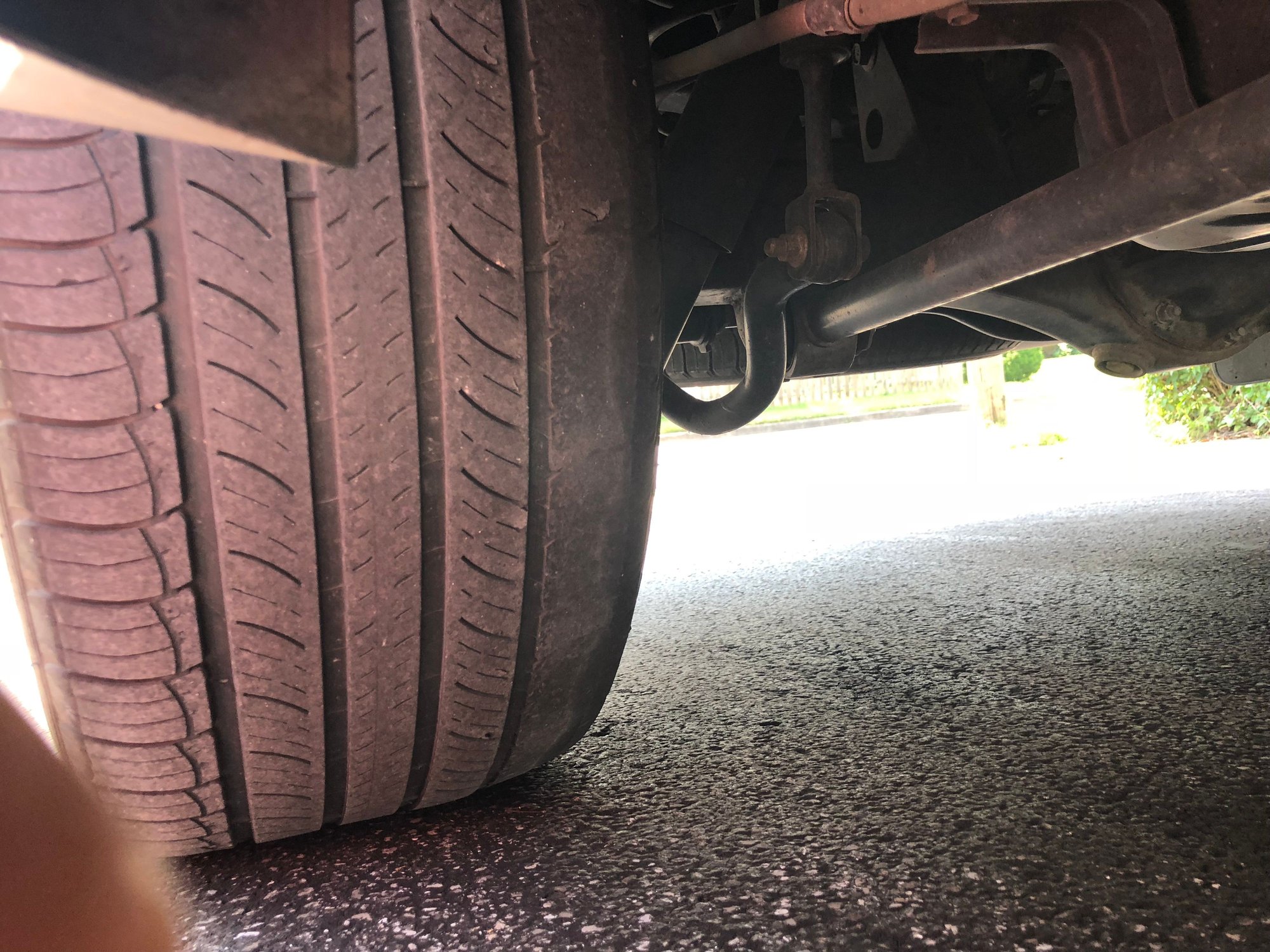

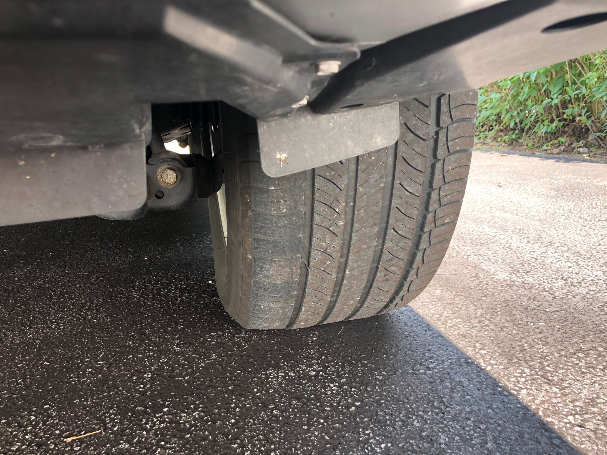

About 3 weeks later, I climbed under the car and see that the front tires now starting to wear unevenly so I’m starting to think that this is not the alignment issue. I have attached the pictures of both front and rear tires right now. We don’t care about these tires since we’re going to replace them anyway but we don’t want the new set to wear unevenly like this one. The first pic is the front tires and the second is the rear tires.

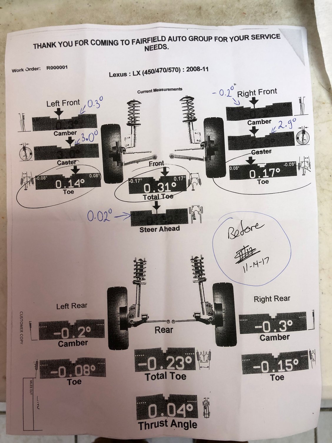

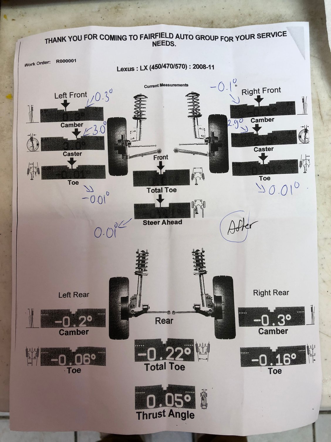

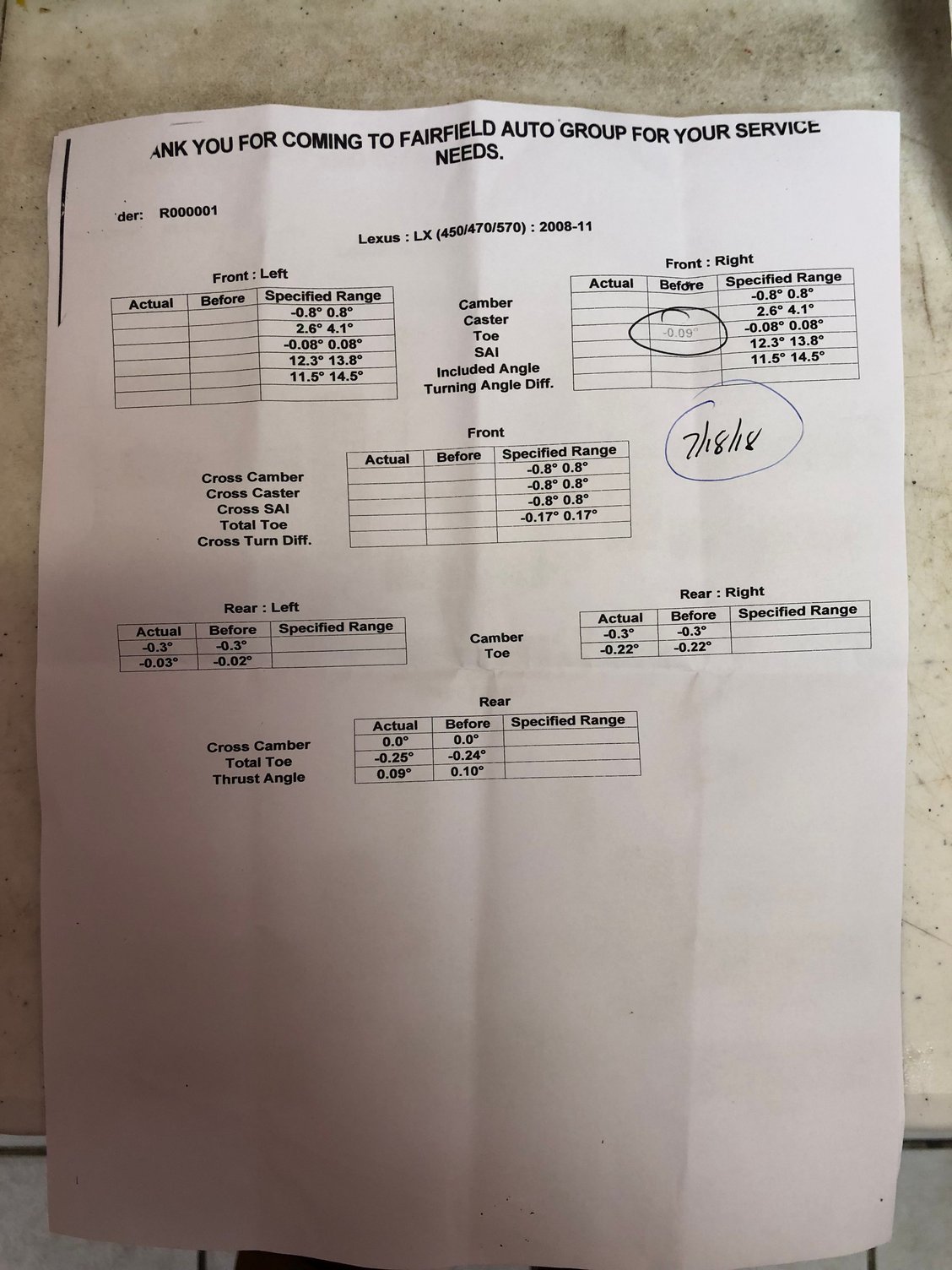

I uploaded the pictures of alignment. The first 2 pics are right after they replaced the inner and outer axle boots. The last one Is the most recent one.

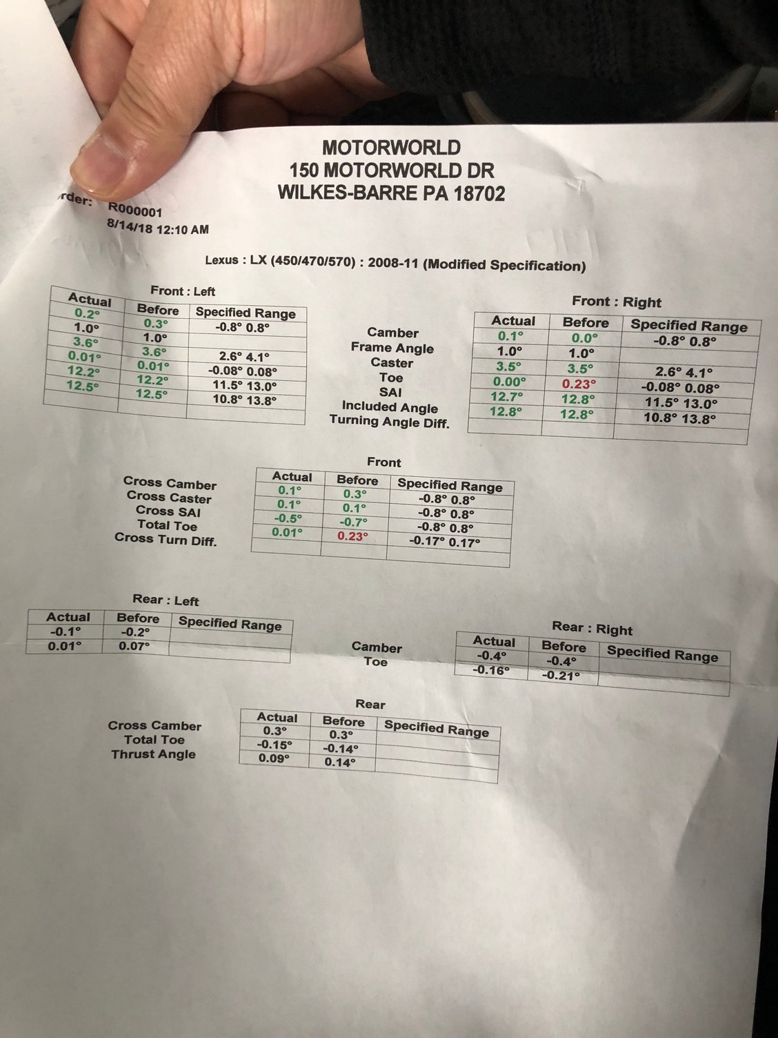

This is the alignment sheet they gave me after the alignment was done. They told me if there’s any problem they will reperform the service at no charge. I’ll have a new set of tires install this week, we will see how it goes.
