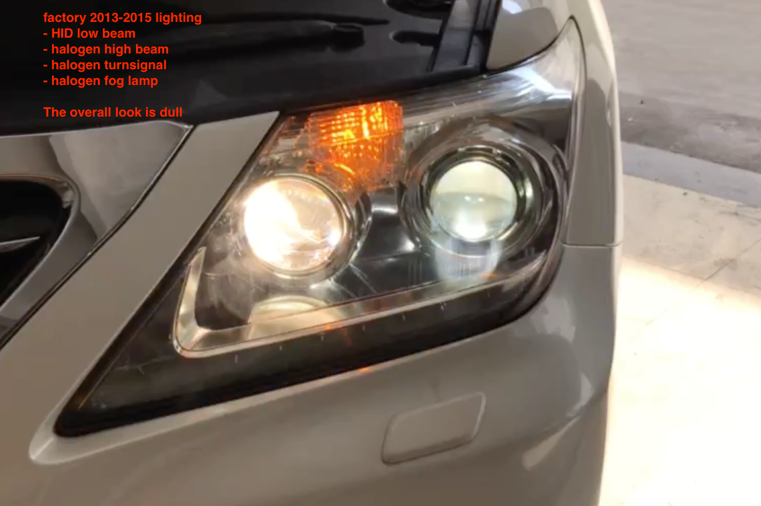

Cnlight is one of the OEM manufacturers behind Philips lighting. They are awesome and reliable, tested thoroughly by our local 4x4 club members running in storm/snow/water crossing. I have them in my fog lamps and my previous Prado 150. I intend to install them on my high beam as soon as I figure out how to deal with the plastic cap that blocks the fan.
Here is how I modified the dust caps on my LX:
https://forum.ih8mud.com/threads/any...#post-11232935
Thanks for sharing. That is one piece of precision work. I probably will modify mine based on your solution.
Below is how I solved the problem and improved my high beam and turn signal lights.
