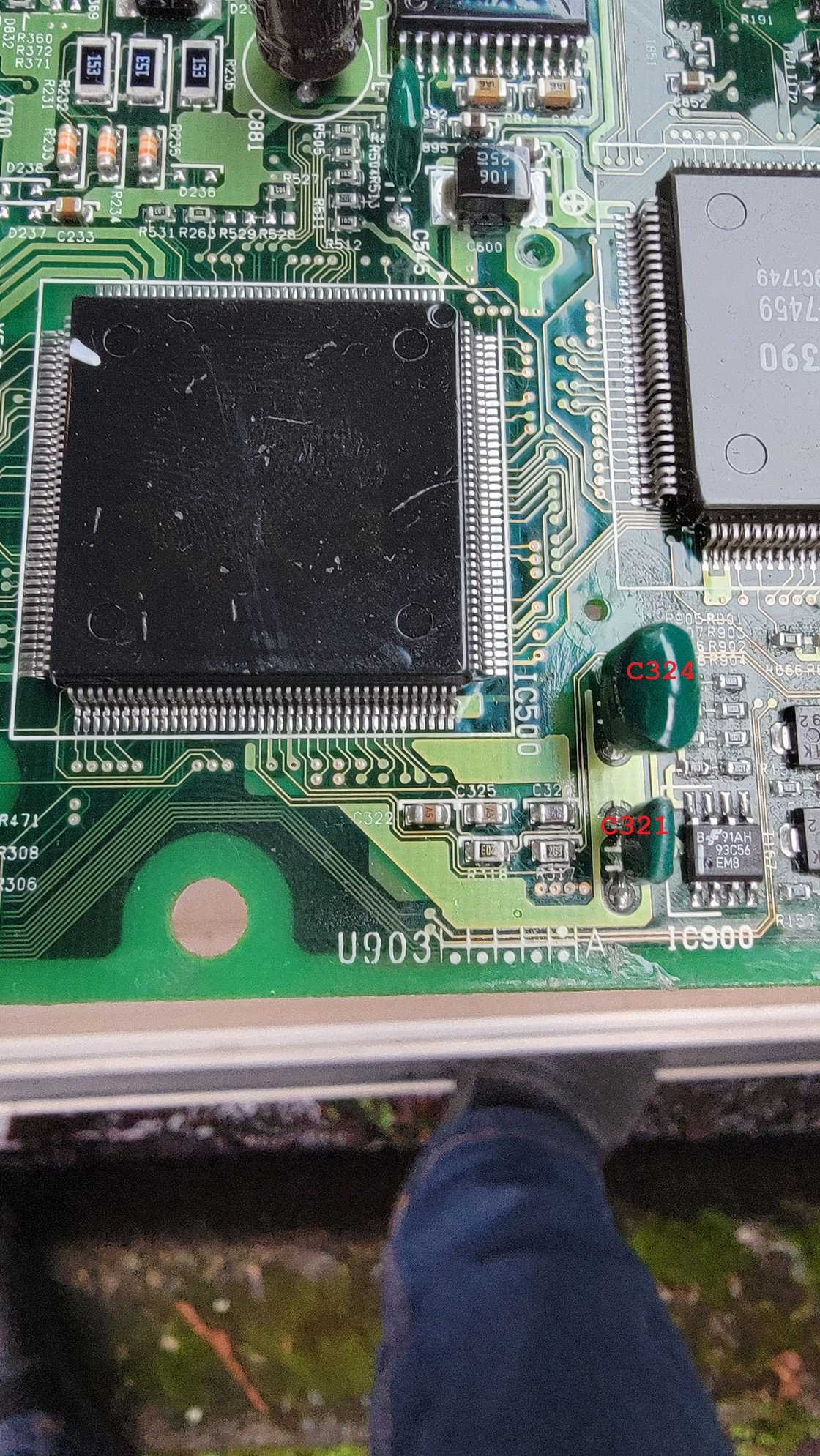

Default 1999 Lexus LX470 engine ECU 89666-60261 , Knock Sensors errors
Have 1999 LX470
Knock sensors errors , P0325 and P0330.
Low power , bad gas mileage , just sluggish.
Replaced sensors 4 times ( 4 times ) , last time good used with harness from 2001 Tundra, NOTHING.
Open up ECU , capacitors C324 and C321 had cracked. C324 was shorted out completely. Zero ohm's.
Replaced capacitors from donor ECU from 22001 Tundra.
DTC's gone , car drives fine.
