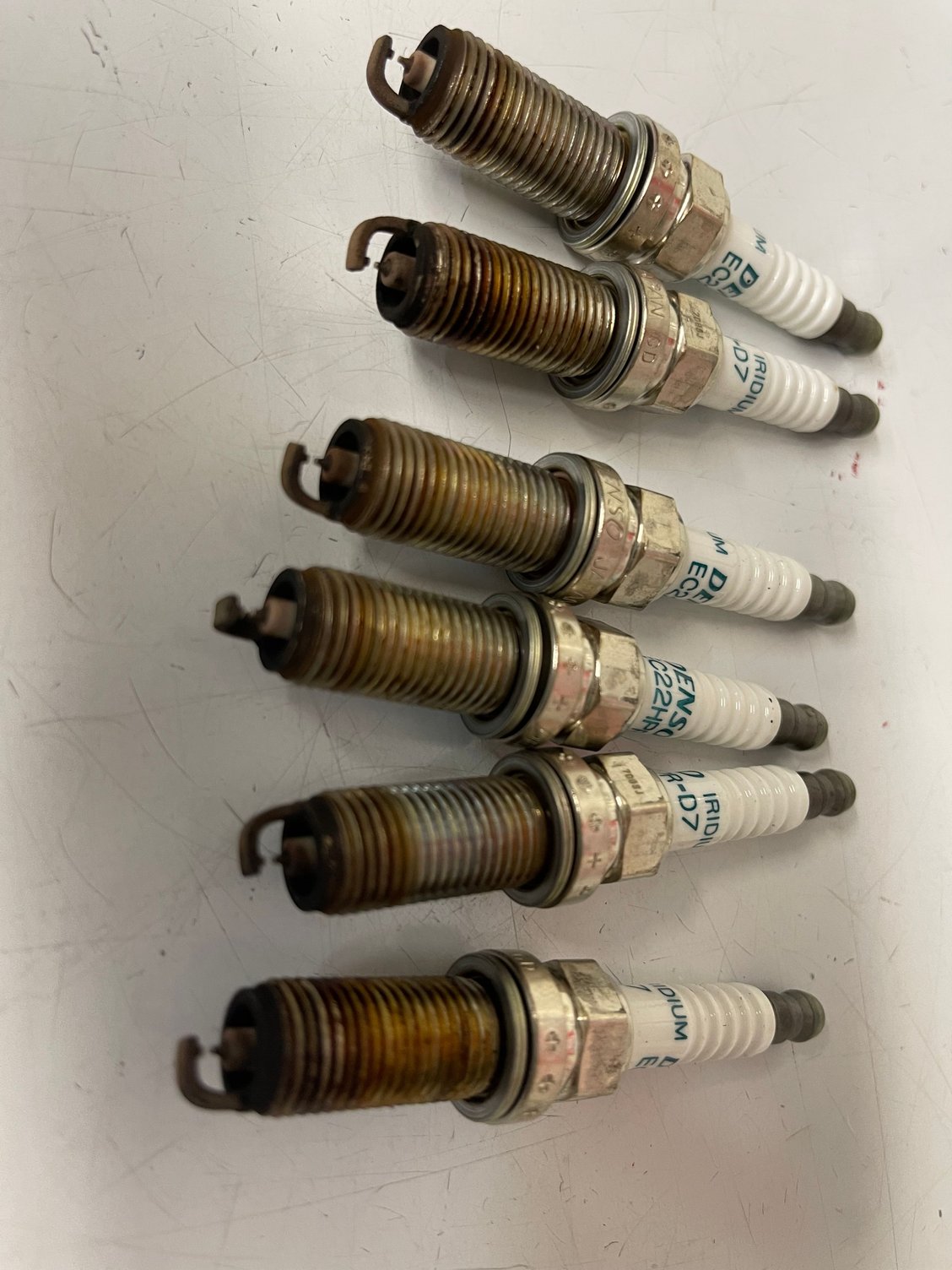

Old May 5, 2023 | 04:13 PM
sajack's Avatar
sajack
Joined: Jul 2012
Posts: 853
Likes: 256
From: Arkansas
My 40,000 mile plugs, look okay to me.
