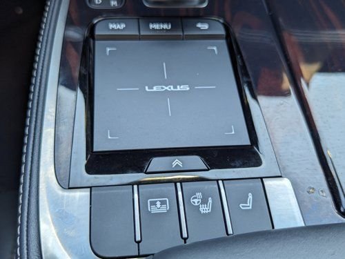

so if it’s missing the first button with the car symbol and up arrow, it doesn’t have air suspension?
this is 2021. I think I’m going to avoid air suspension this time as I want to keep the car after the warranty period and I don’t want to deal with a 2500$ per corner just on the part for repair.
I think this is the way to go.
