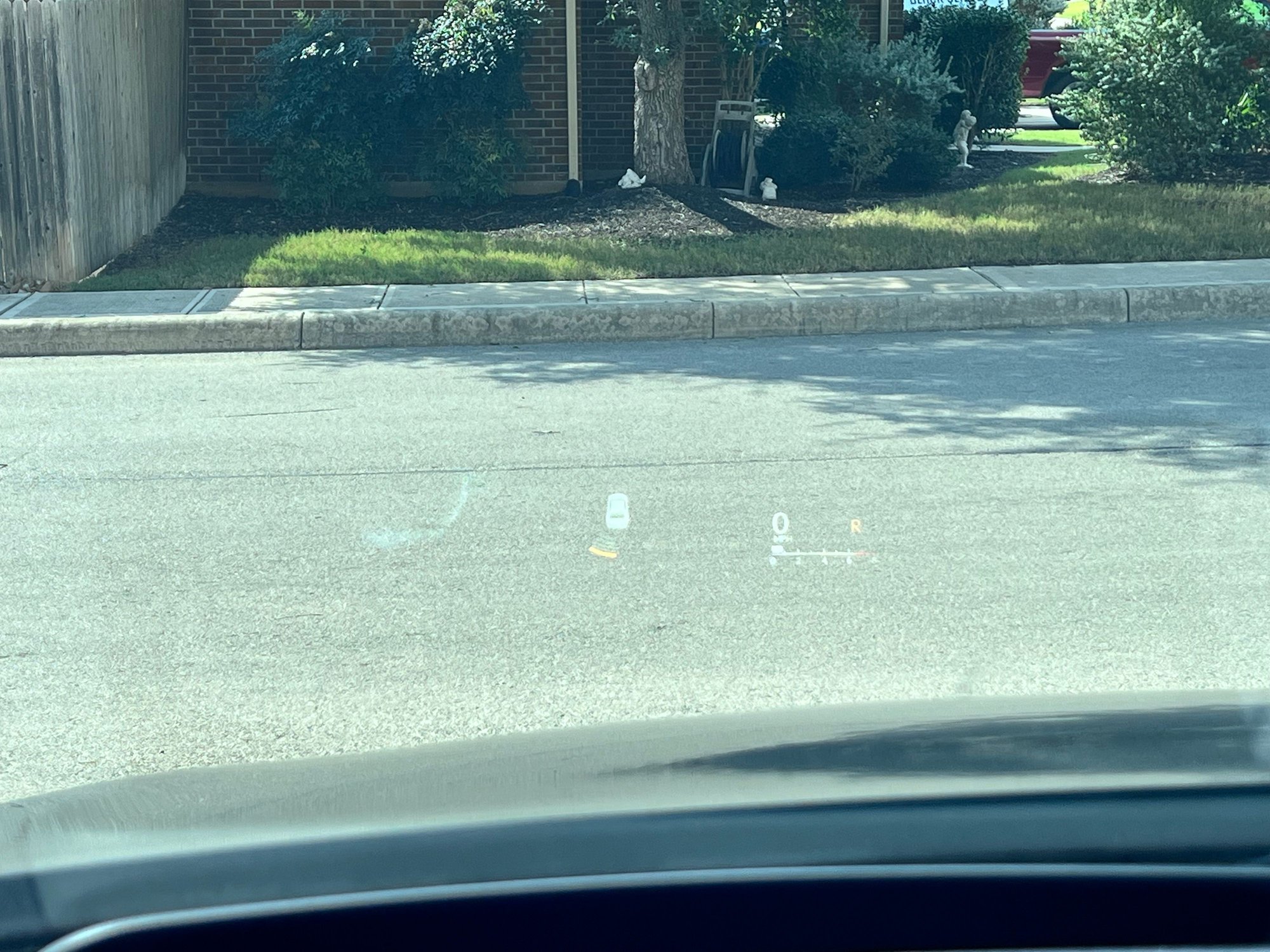

You may have to look hard but the white mark in question is to the far left in the pic. It almost looks like a backwards Lexus emblem.

Thanks for the Pic. I think I see what you are talking about. Looks to be about where the compass normally is. Does your HUD still show the compass if you select it? That might cover the defect enough to live with it ? Sorry you are dealing with this

The area can be seen over the compass got larger and eventually the dealer replaced the entire unit.
