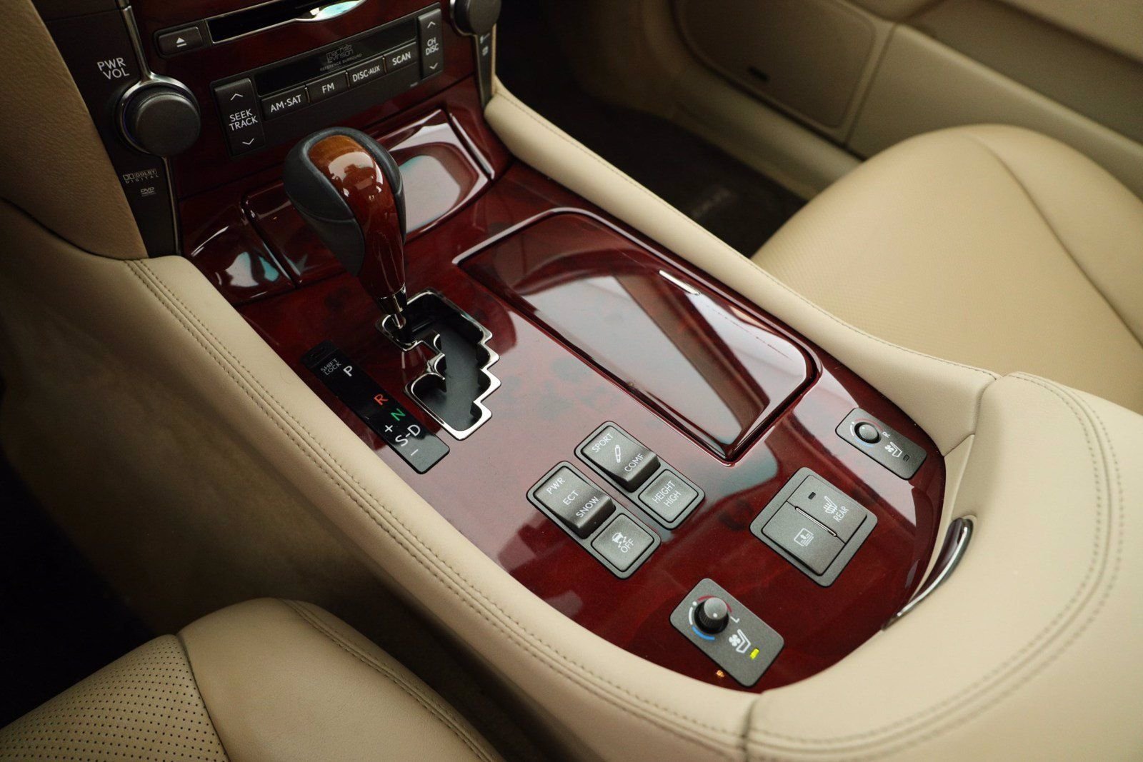

I attached a pic of the console of the car I'm considering buying with AWD. Does yours, without air suspension, have the button for "Sport/Comfort" and "Height Hight"?

Cars without air suspension do not have suspension height and firmness switches.
That answers my question. Thank you.
