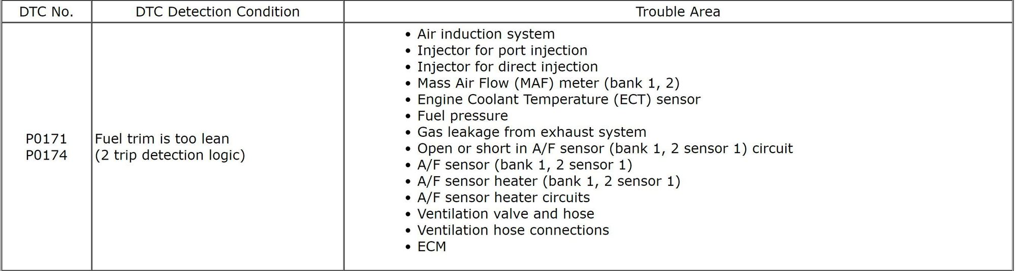

Check the following..
hi thank you. I have checked vacuum lines and maf sensors. I am suspecting the guys may have messed with vac lines but there are not vacuum leaks. However I will replace the maf one on maf two and check if the error comes on bank 2
