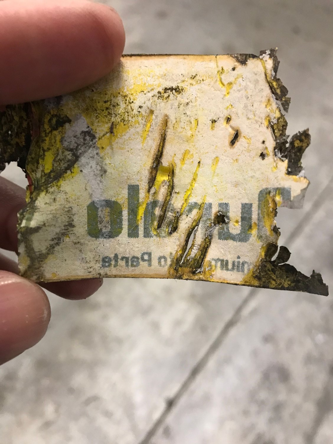

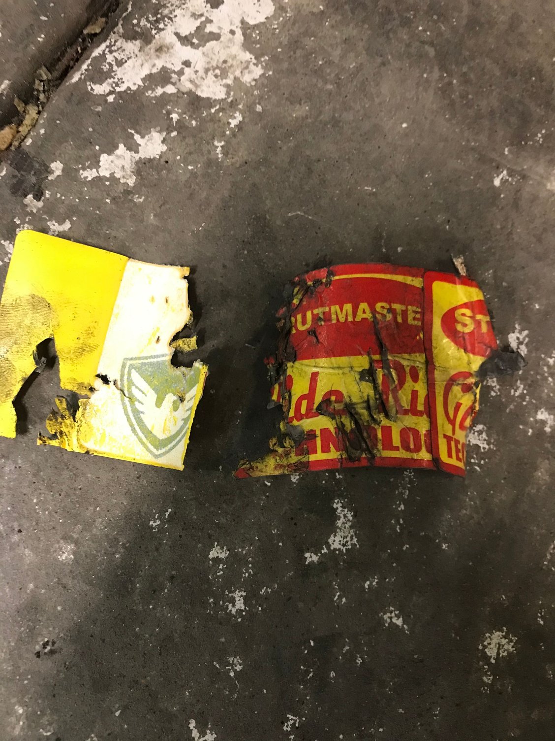

Hi everyone,i have a LS460 2010 awd,I bought it one and half years ago,the previous owner told me he had replaced the air suspension with a Strutmasters conversion kit,when i test drove it I noticed the common noises in the front suspension,not knowing the price of the parts I negotiated the price a little($1000)while owning this car i have replaced the lower control arms with oem parts,the upper control arms bushings with Figs bushings,still the noise was there,so my mechanic says that the coils of the front struts have failed,when taking a look at the struts i decided to remove the sticker to see what brand of shocks they used,to my surprise i found that they are Unity struts(yes,those chinese struts you buy on walmart for $220 the pair)in their website Strutmasters claim that they use Bilstein,Monroe or KYB,what a ripoff company,it is a shame that there is not a decent brand of shocks making these conversions kits,supposedly Strutmasters made a better product that Suncore,now i have no options to replace these struts.....i have the pics but i can't find how to attach them to this post,if someone could please explain me how to do it i will post them

These are the struts i got

Default Strutmasters coilovers air conversion kit
These are the struts i got,as yo can see they used Unity struts that you can buy for $220 the pair and just put their stickers on them,no wonder they started to make a noise after a few months,it seems like the coils are not strong enough for the weight of these cars
well of course lol you pay for what you get,... people should at minimum use kyb gas adjust and move up from there if they can find something suitable. There are brands like koni etc they don’t list our vehicles but I think people can find something suitable. If you can take sone detailed measurements I’ll do the experimenting and get a proper new and innovative solution for you guys out there, if you can do it, let me know I’ll tell you what I need. Thanks

well this kit of Strutmasters costs $1000 dollars,they claim on their website that they use KYB,Monroe and Bilstein shocks for these kits as well as einbach springs,my complaint is that instead of those brands they actually use Unity struts with you can buy assembled(just like the ones installed)for $420 the set of 4
