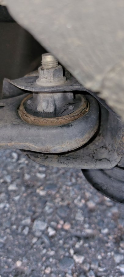

Anyone have any thoughts on how bad these bushings look or potentially how much life they have left in them? I have a 2009 Rx 350 and was told the bushings were cracked and was recommended to get new control arms. Have gotten about 8 different quotes and all expensive. I'm currently at 154,000 miles and hoping to get to 200,000 miles.

Those are beat…….. Change them out and you will thank me later.
BTW! You are in the LS discussion thread…….. Try jumping over to the RX section.
