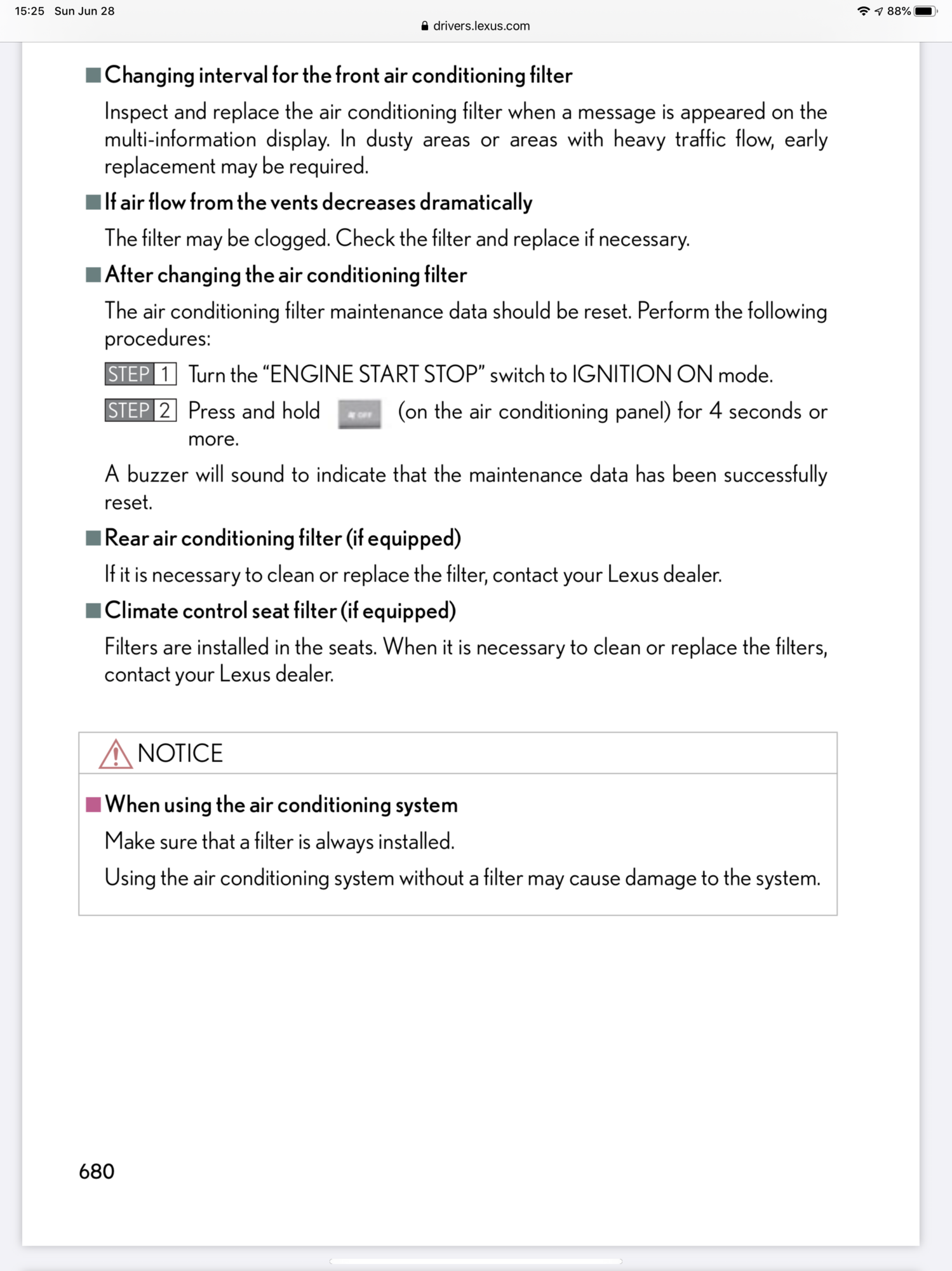

why the message " change air conditioning filter" still shows on startup even after changing. Ive changed it 6-7 times over the years and the message always goes away when its changed!🙃 not this time!

Need to reset it ,Look in owners manual

Yep, needs to be reset.

yes, it worked just fine. its odd its never had to be reset, but hey, it worked!
