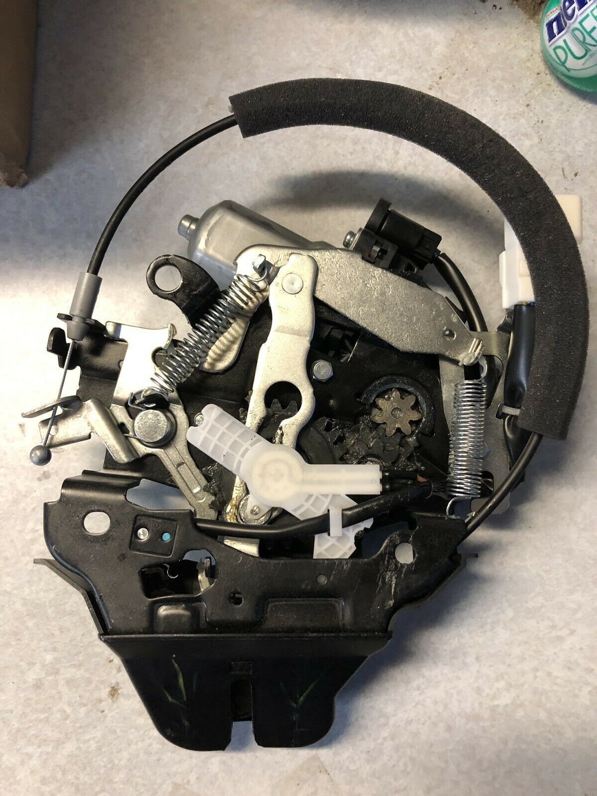

Oh I have a feeling 2013+ will start to fail as common as the 2007-2012 very soon. The trunk latch motor in a 2013+ looks identical to the 2007-2012s
The general life expectancy of these latches appear to be about 8 years. I still see the same plastic arm/gear used which breaks over time
2013+ & pre 2013 latch below....

I had the same trunk-closer issue with my 2013. It failed in January immediately after the first time I parked it outside in sub-freezing temperatures overnight. Maybe it was ready to fail and freezing it finished it off. I ordered the part from Bell Lexus in Arizona and replaced it myself in an hour or so.

Ok, got the car back all is working and fine now, cause listed as "OPEN CIRCUIT INSIDE BACK DOOR LOCK MOTOR ASSEMBLY. REMOVED AND REPLACED BACK DOOR LOCK OPENER ASSEMBLY."
