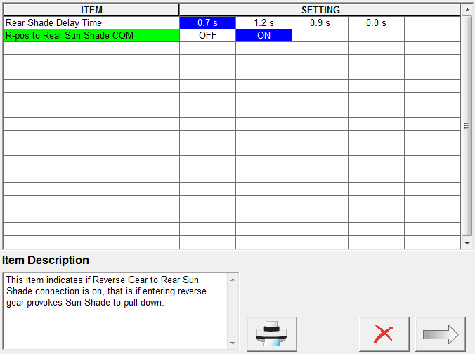

I've got a rear facing dash cam that barely interferes with the rear sunshade when it's in motion and I'm noticing it's more of an issue now that I keep the sunshade up. I do not like that the sunshade retracts automatically when the car is put in reverse. I searched the forum and searched through the vehicle settings and it doesn't appear that can be changed. Does anyone have information to the contrary?

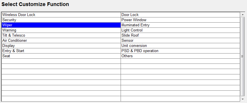

You should be able to disable it with Techstream, in the customizations, under "Others" if I remember correctly.

Yes you can turn it off. I used my Crista App to do it. I have mine set to never go down.

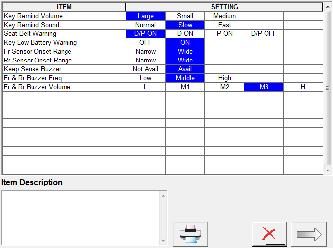

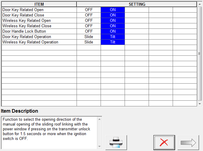

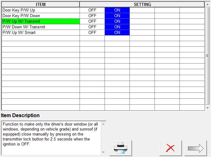

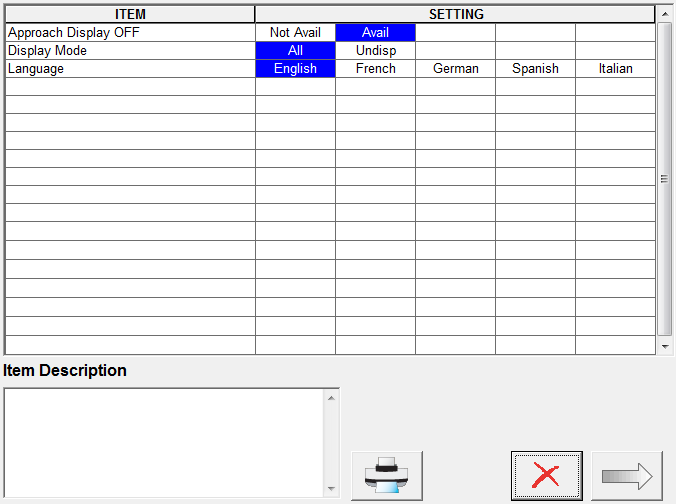

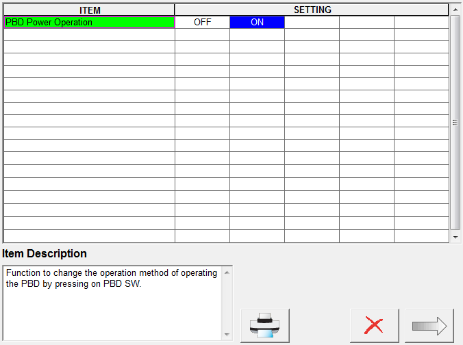

Originally Posted by 99rx
Thank you all! I think I'll be purchasing the Carista App. What other personalizing for the LS460 can you do on that app?
Your car is newer than mine, and different markets may have different customizations (like my EU market LS600h lacks DRL functionality in the menu, as seen on US market cars).

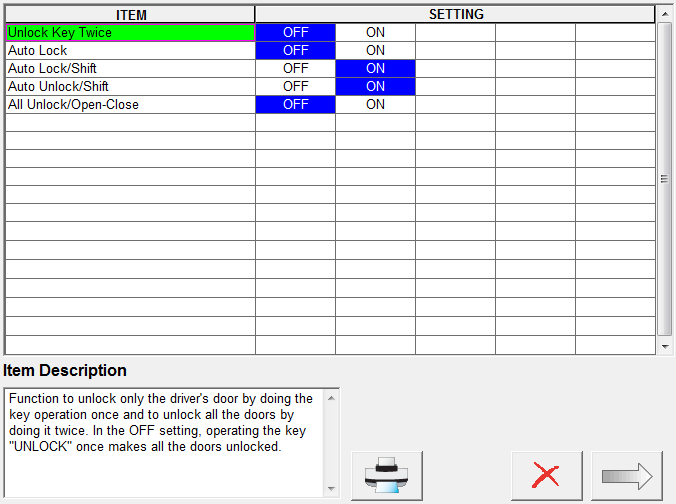

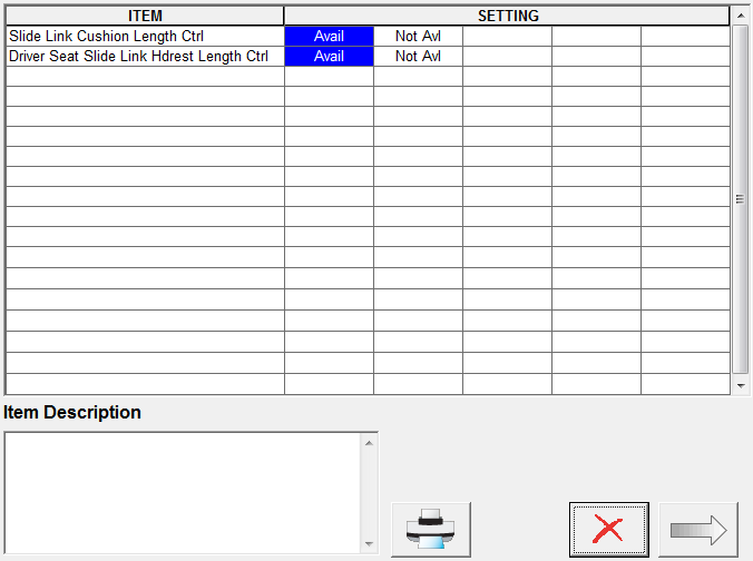

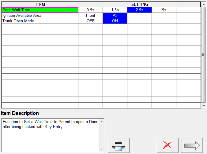

Anyway, I happened to take these screenshots before, so here goes:
main menu
air conditioner
display
door lock
entry and start
illuminated entry
light control
other
power window
psd and pbd
seat
sensor
slide roof
steering wheel tilt telescope
unit conversion
warning
wireless door lock
