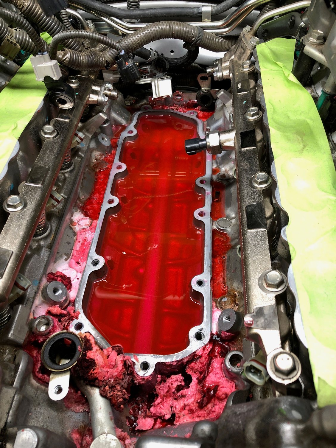

This happened to me! The first winter season we replaced the coolant and burped the system. Worked fine for awhile, until this winter season. It did it again! Come to find out the valley plate is leaking coolant. It leaks and puts air bubbles in the system so the heater doesn't work properly. It's very expensive job but worth it in the sense that if left alone could damage other components.

Its deep down in the engine. Photos attached of my car of where coolant should be and shouldn’t be (where its all crusty).
