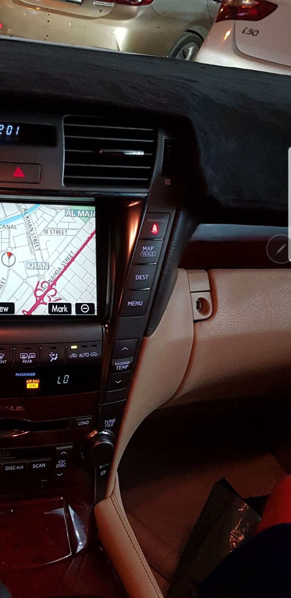

Passenger button only blinks
Map button should illuminate
Problem is fused led bulb
Old Jan 31, 2020 | 03:46 PM
hammer1234's Avatar
hammer1234
Joined: Nov 2016
Posts: 6
From: il
Great picture,
exactly what im talking about.
The pass and map no longer lite up.
how can i fix it?
thank you

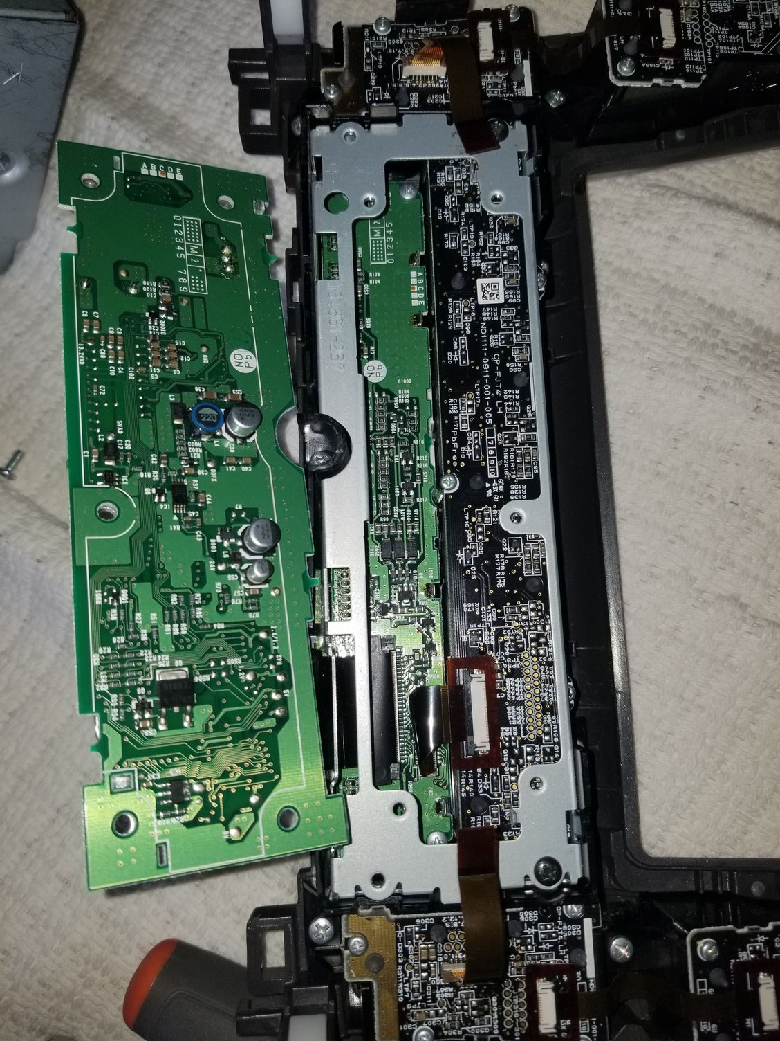

Pulling the dash is the " easy" part. Taking the unit apart is a lil more involved, then trying to get it back together can be nerve wrecking. I have pics of mine completely apart. I'll post them later when I get to my computer if you want to attempt it.

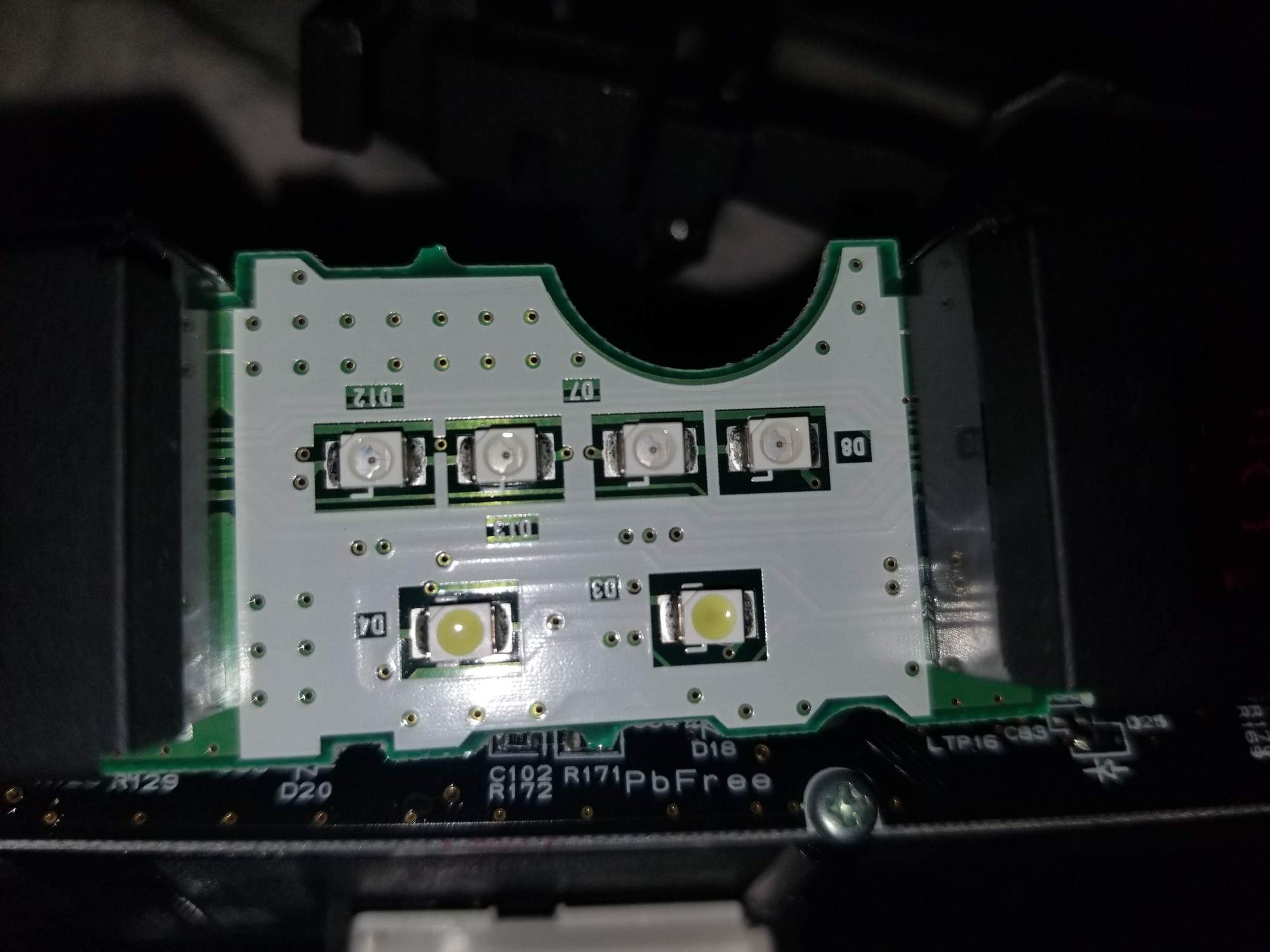

Old Feb 13, 2020 | 07:46 PM
sha4000's Avatar
sha4000
Joined: Aug 2005
Posts: 6,858
Likes: 347
From: N.Y.
Here's a couple of pics.
