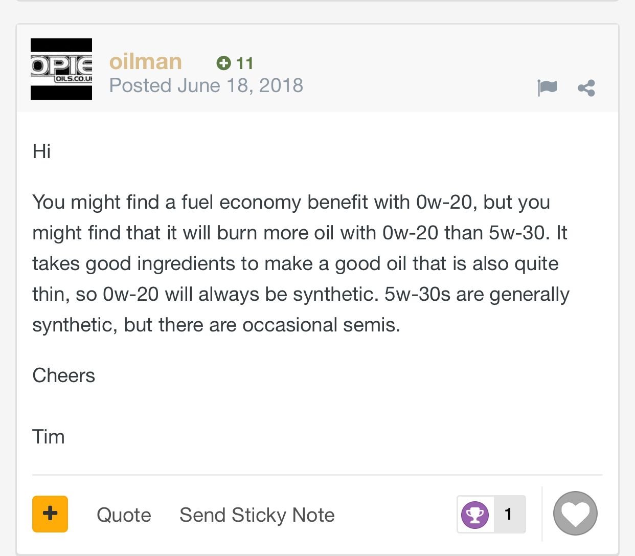

I read on another forum that using 5w30 will help with oil consumption maybe that’s why the previous owner did it
