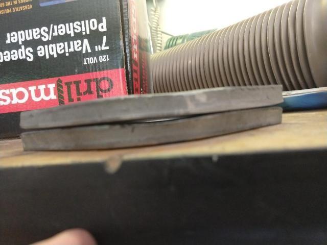

After this you will need to take an angle grinder with a grinding disc and TO YOUR LIKING, grind off as much or little as you want on the bottom depending on how much sound want. If you want it subtle be easy on the grinding, you dont need much at all to get that much more sound out. This is how much I did:

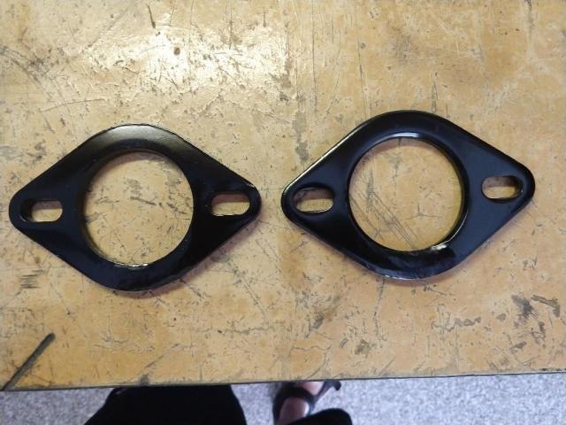

After that, I would recommend sanding and painting the flange with a high temp ceramic paint with 2-3 coats because moisture will escape out the vent and rust it quick.
Time to install. I forgot the gasket part numbers but if you go to NAPA or another parts store have them match a gasket to the flange. This is not a perfect seal with one gasket, so 2 gaskets per flange would be ideal but not required. I used 1 on each flange but may go back and get 2 per flange (sandwiching the flange). Take out the old exhaust donut gasket. The stock bolts have enough room still to grab that I would consider acceptable.
All done
