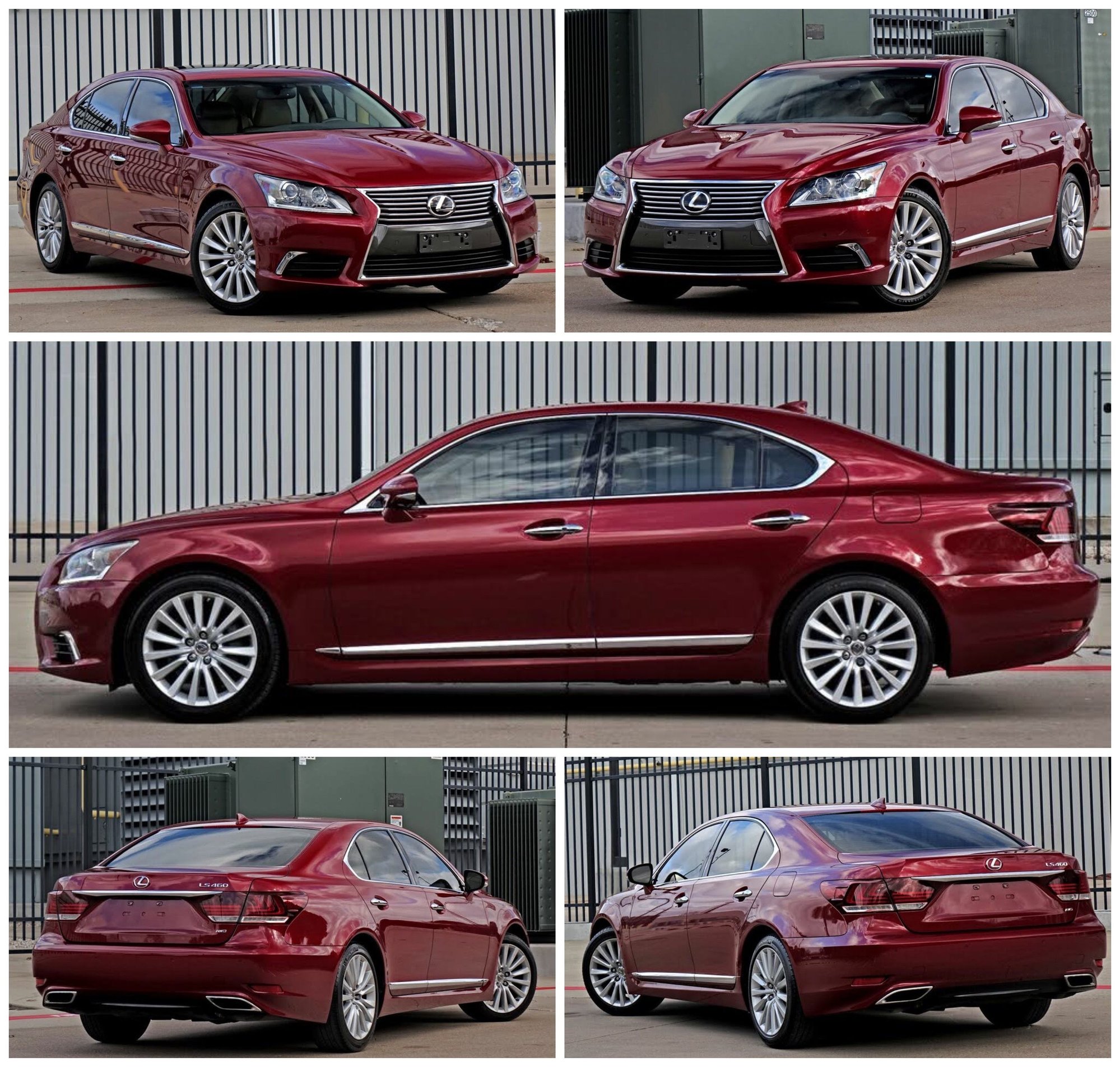

Default “Grabby”, Sensitive Braking Solved
My new-to-me 2014 LS AWD exhibited “grabby” braking as well. At first I thought it was just something I needed to give some time to adjust, and I did get a bit more comfortable with it within the first couple weeks.
The main issue I never fully adjusted to was the non-progressive nature of the pedal. When a sudden change in traffic ahead resulted in more urgency to slow the car, it would often grab too hard to slow the car or bring it to a relatively gradual stop. There was also a variability when braking normally to come to a smooth, gradual stop.
_________________________
Akebono 1282 and 1283 ceramic pads to the rescue!
This past weekend, a month after I bought the car, I swapped the original pads for Akebono as some have suggested. I did not replace or turn the rotors since they were in very good condition (only 23K miles on the car).
I used the shim that came on each of the new front pads plus the original outer shim. I applied a thin layer of Sil-Glyde on the pad and shims to prevent squealing. On the rear pads, the original outer shim would not fit due to the tab placement of the shim on the Akebono pad. I removed the Akebono shim and used both original shims on each pad, again with the Sil-Glyde.
What a difference! With the Akebono pads, the grabby-ness is non-existent and braking is progressive and still super solid. I do have the faint ABS clicking with lighter braking, and it wasn’t changed with the pad swap.
I highly recommend this update –especially if you can DIY since it costs only about $100 for the pads plus 2-3 hours from wheels up to wheels down.
I’m extremely happy with my new ride!
