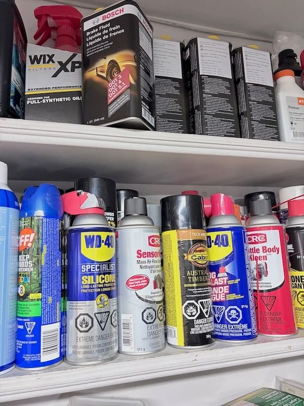

Every 2 years, I use ESI6
I bought some of that to try next time.
