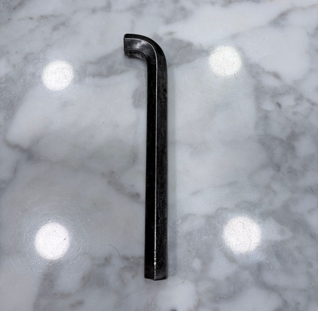

What I have even tried is to hack off the end of a 10mm Allen wrench to see if I can get that in, and then use a flat wrench. My problem again is narrow access and I cannot "tap" the 10mm hex into the Fill Plug hole. HELP!!

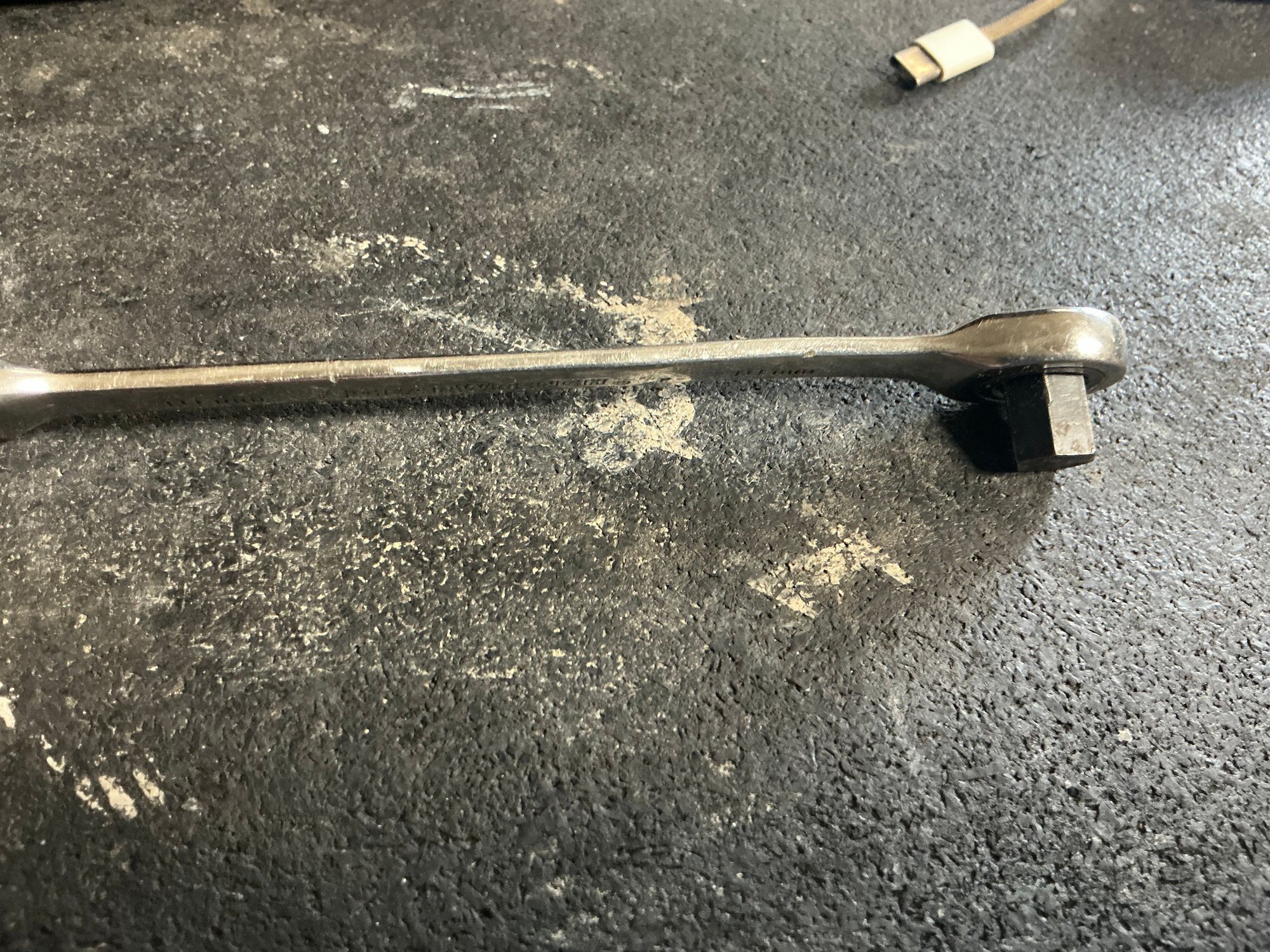

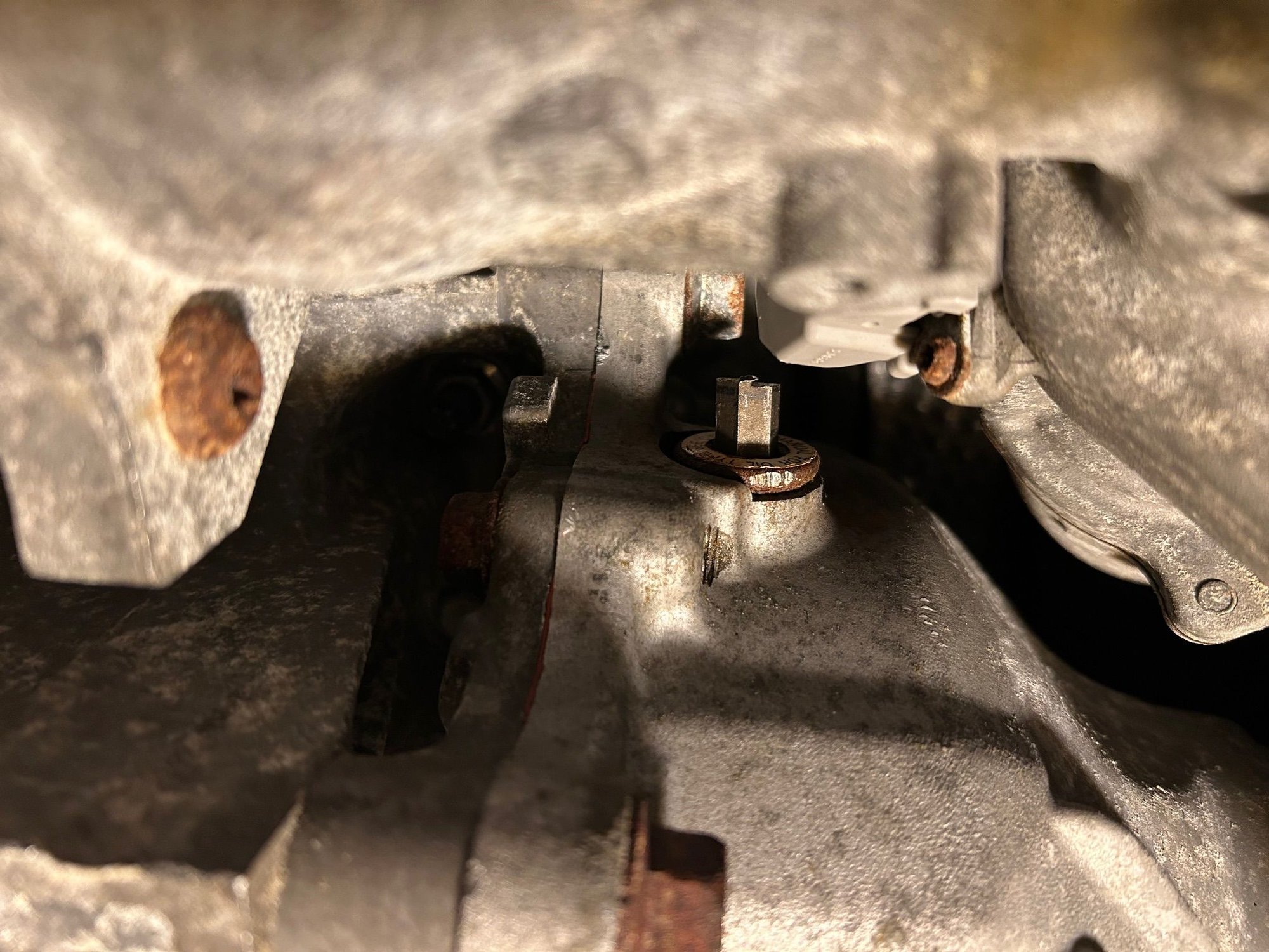

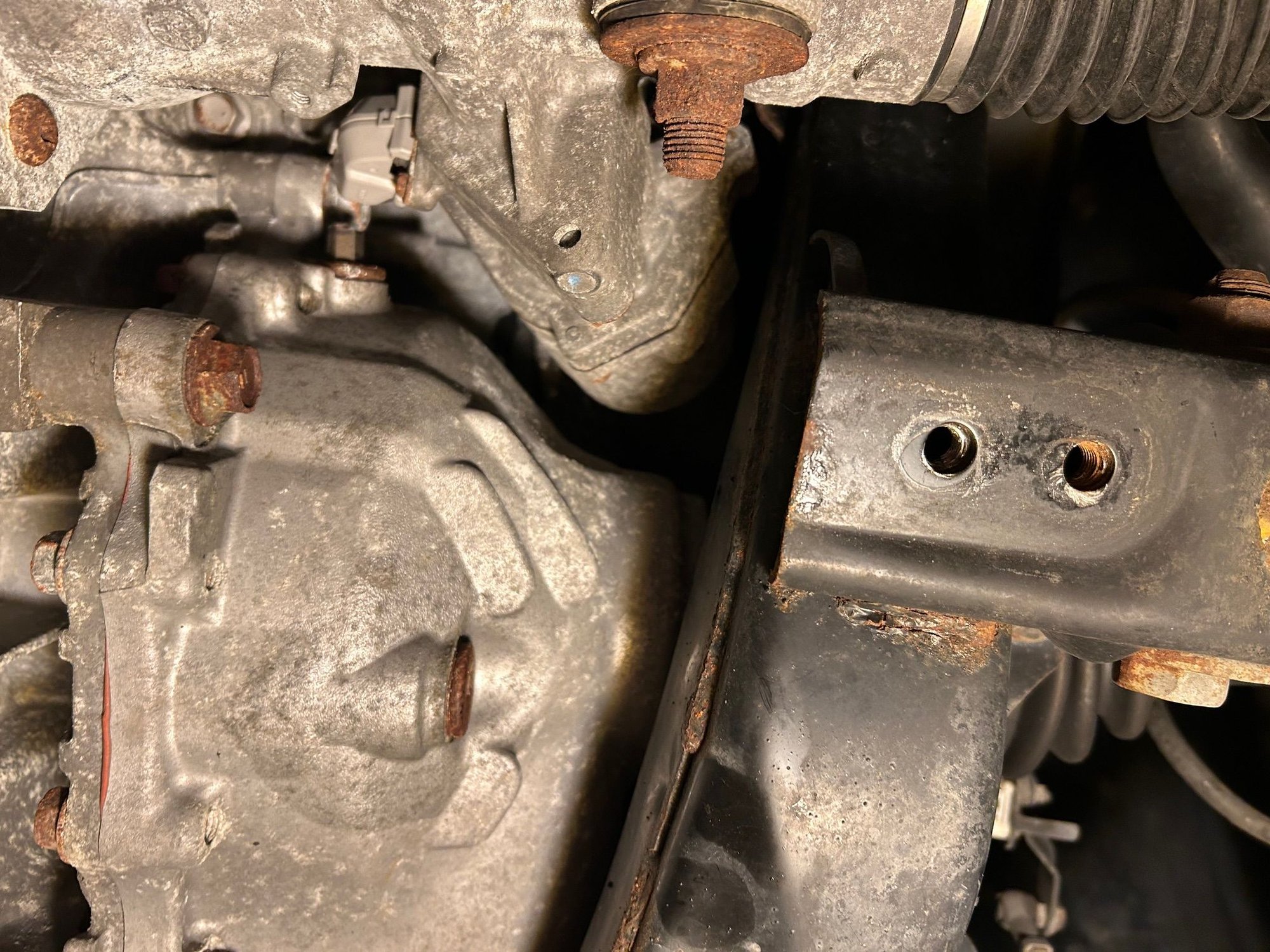

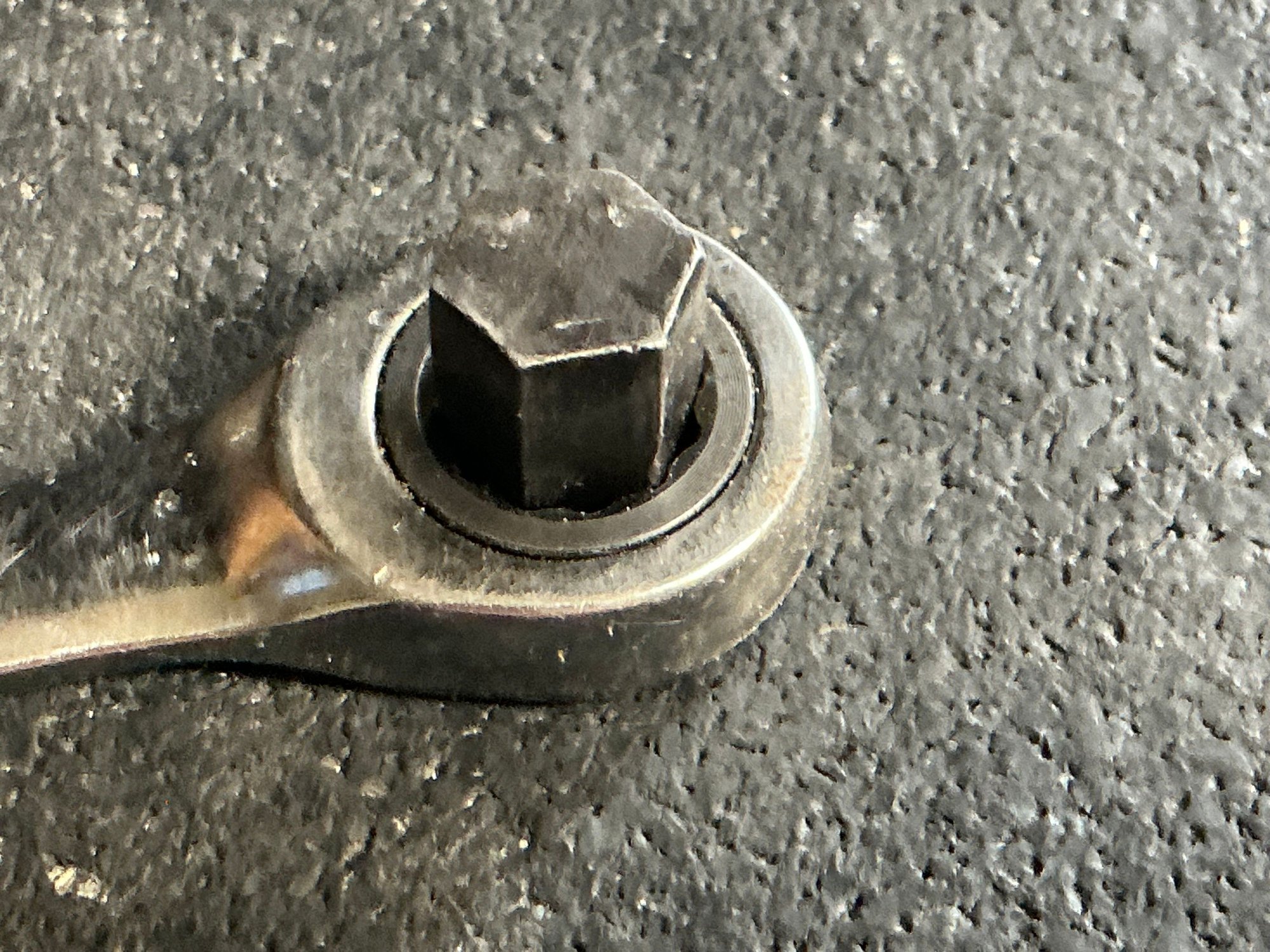

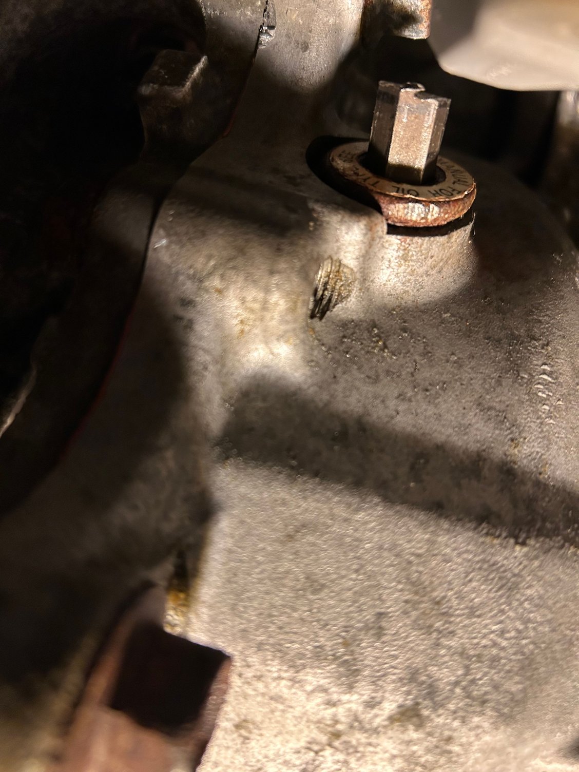

Here are some pictures of what I have tried with the tight space. There is not enough room to fit a typical socket wrench and 10mm in that space. There is no room to come in from the front bumper as that grey plastic wiring harness is in the way too. So I tapped the plug a lot, tried to clean out the inside, blasted w break away, etc. I did get the small end of the 10mm Allen wrench to FINALLY fit inside somewhat firmly. But after lots of effort including some banging the end of the 10mm wrench I can slip over the 10mm Allen, it still does not budge. And it is such a stupid location and such a stupid design! I am concerned of stripping the darn thing and making a huge project out of what should be a simple task.
Front Diff FILL plug w my 10mm Allen piece inserted
in this picture, you can see there is hardly any room whatsoever. Also above the 10mm Allen you can see that grey harness that is on the steering rack, and I am not sure if removing this "somehow" will give me lots of new found room to work?!??
my 10mm Allen close up. And I am trying to turn the darn thing "lefty loosey", or counter clockwise in this picture.

When I did mine I used this cut off Allen inserted in the fill plug and put a piece of 1" galvanized pipe on the end for a snipe to break it loose, worked for me. If you can't make that work I would get a long punch with a chisel end to break it free and buy a new fill plug.

Use a 10 mm ratchet wrench attached to your cut off Allen.. I used another wrench over the 10 mm wrench as a pry bar .

Quote: Use a 10 mm ratchet wrench attached to your cut off Allen.. I used another wrench over the 10 mm wrench as a pry bar .
This is how I normally access that port as well

The dealer installed 2 new plugs for FILL and for DRAIN as the originals were so rusted. They had to chisel them out/off. TTT
