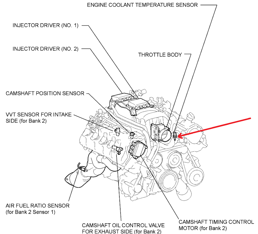

Check both engines' cooling fan motors, there is a TSB for that.
If both engine cooling fan motors check out, then check the engine coolant temperature sensor.
