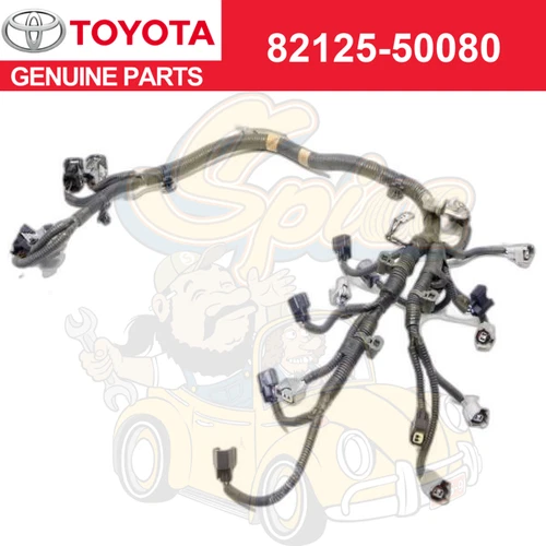

one part i didnt replace is the
Engine Wiring Harness NO.5 82125-50080. i ordered waiting for the part
some of the direct injectors.connectors were brittle

Toyota Genuine 2007-2017 Lexus Engine Wiring Harness 82125-50080 - Picture 1 of 2
