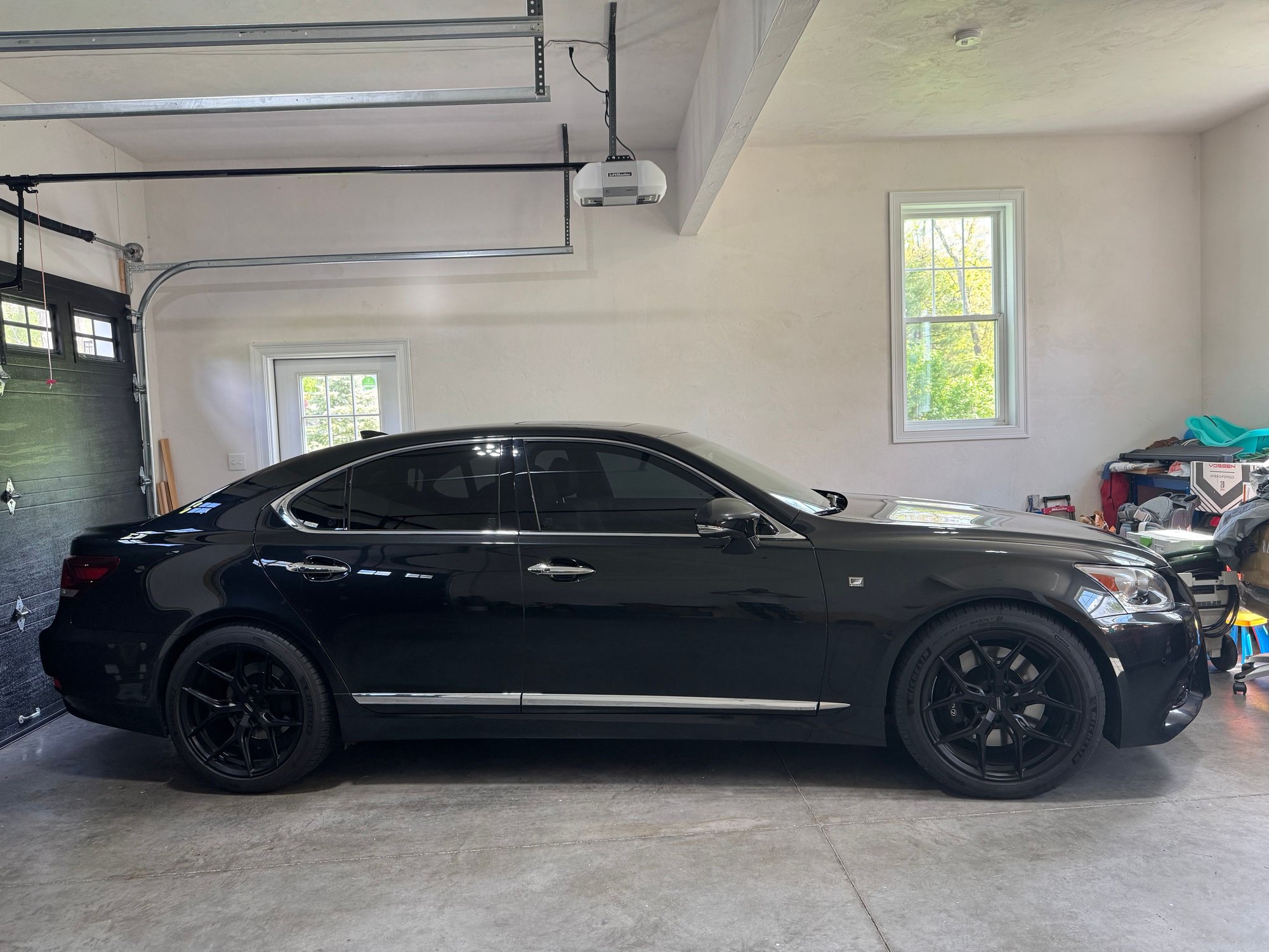

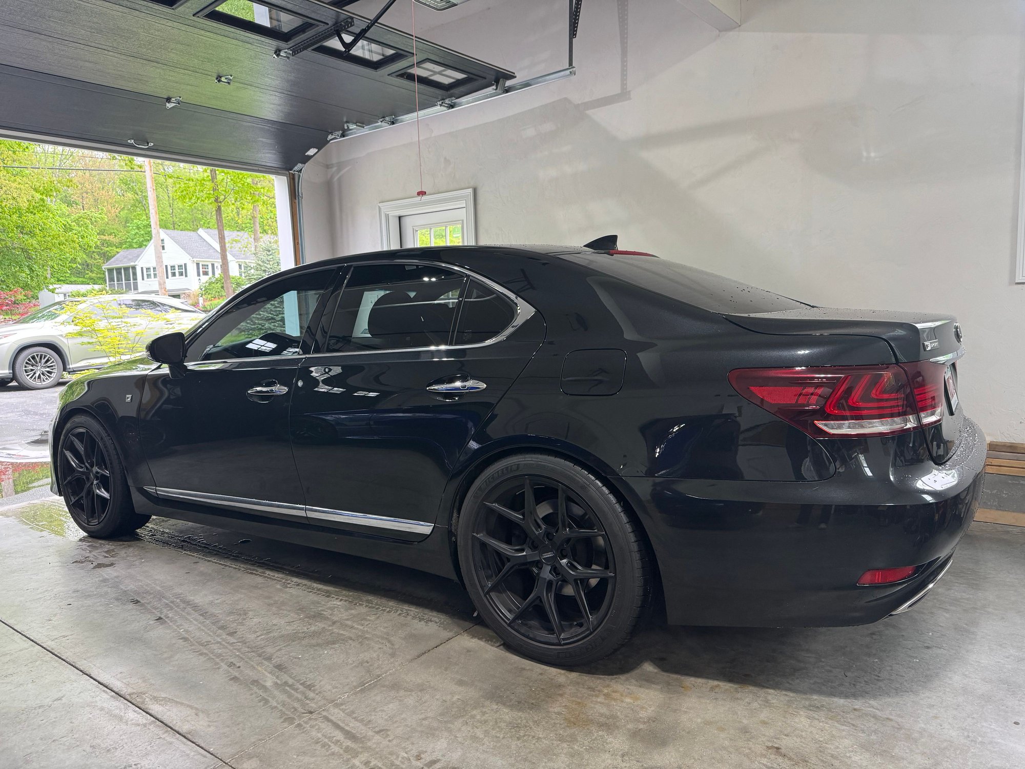

I made a mistake. The wheel size is 245/45/20 and 275/40/20. A difference of 0.1%.
I just put them on today and looking quite good.

Those two should be exactly the same diameter and exactly the same 704 revolutions per mile. They will work fine on the awd and they do look good. Should also give you better handling as the ls awd is rear drive biased by quite a bit.

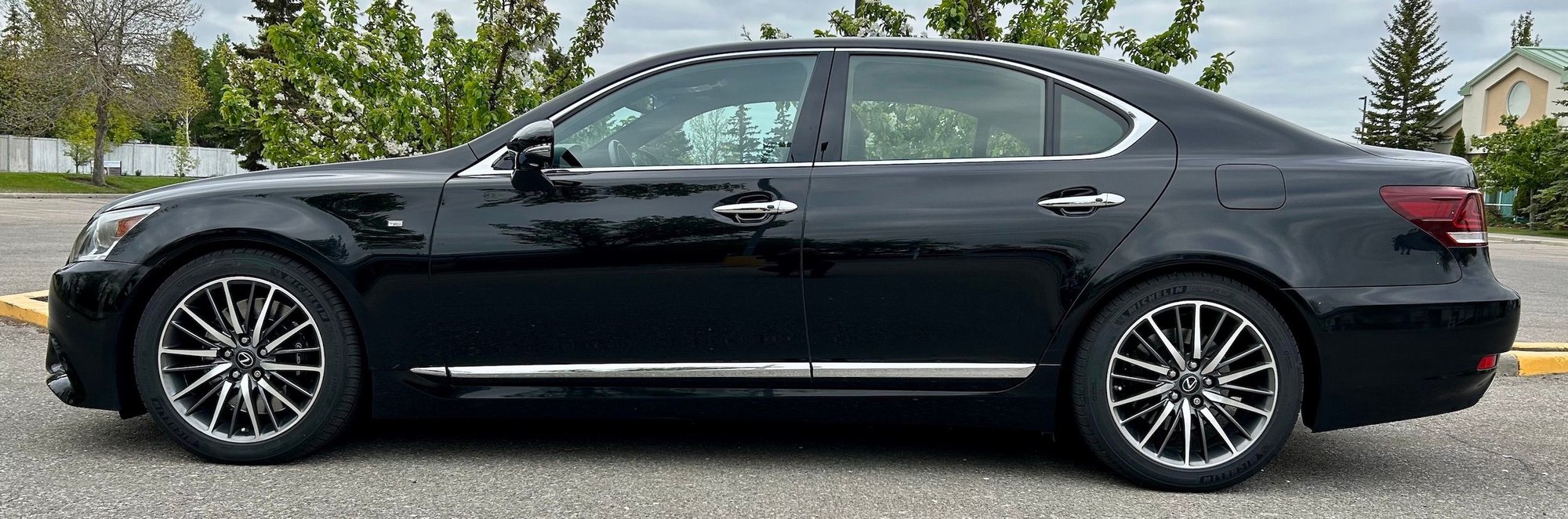

Looks very improved vs the normal setup! Factory has the wheels pulled so far in....

Originally Posted by Gerf
@NickL are you keeping the f sport wheels ?
Yes. That would be the winter wheels for the LS and these Vossen HF5 will be the winter wheels for the LC500. The LS F sport wheels and HF5 are on Michellin AS4. The LC500 wheels are on Michellin PS5.

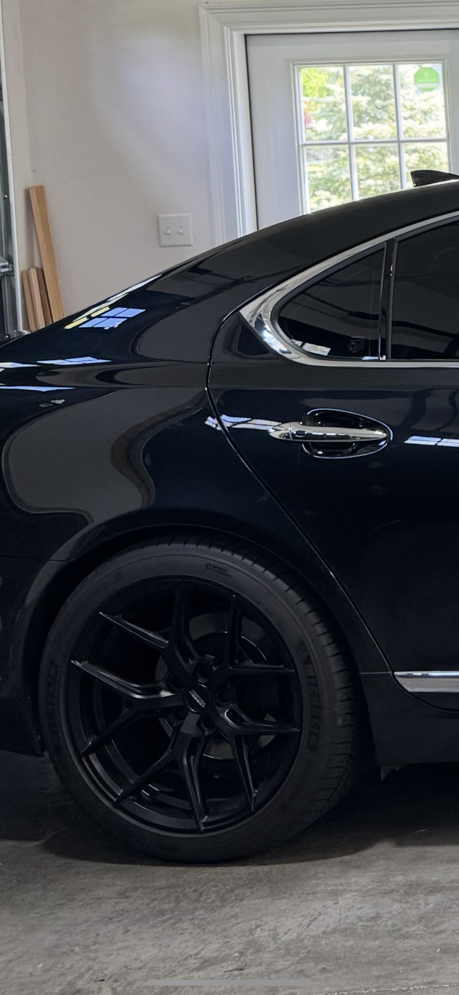

Well, that was short lived. My LS F sport is on air suspension. While the HF5 for my LC look great on the LS, they stick out too much and rub against the outer edge of the fender lining.
They don’t look like they will rub when the car is parked. However, when the car is in motion, the ride height lowers from what I understand. Going over dips on the road, there’s some rubbing noise. The problem is the wheels stick out too much. If they were tucked pass the edge of the lining, it would’ve been fine. I’m not sure if I want to mess with the ride height adjustment.

Yeah. My ride height is about 28 1/4” -281/2”.
I don’t have any height adjustment software to do it.
The Vossen HF5 were meant for the LC500 with +16mm front and +15mm rear offset. While they work on the LC, they stick out too much on the LS and rub against the lip of the fender lining.
I already took them off and put back the stock wheels. It’s too bad because I thought they look great on the LS. I was thinking of sending them back to Vossen and have them shave off the hub so they’re tucked in a bit more.
