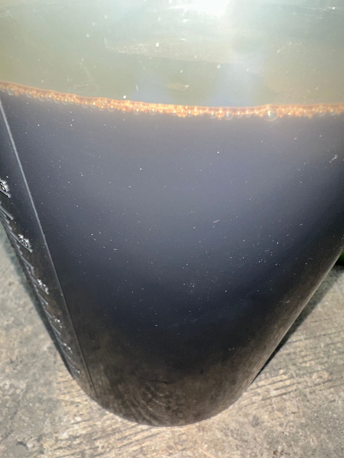

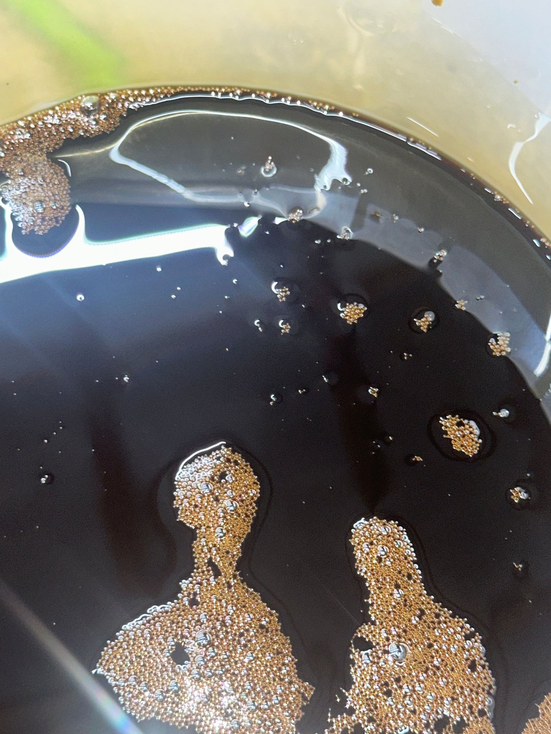

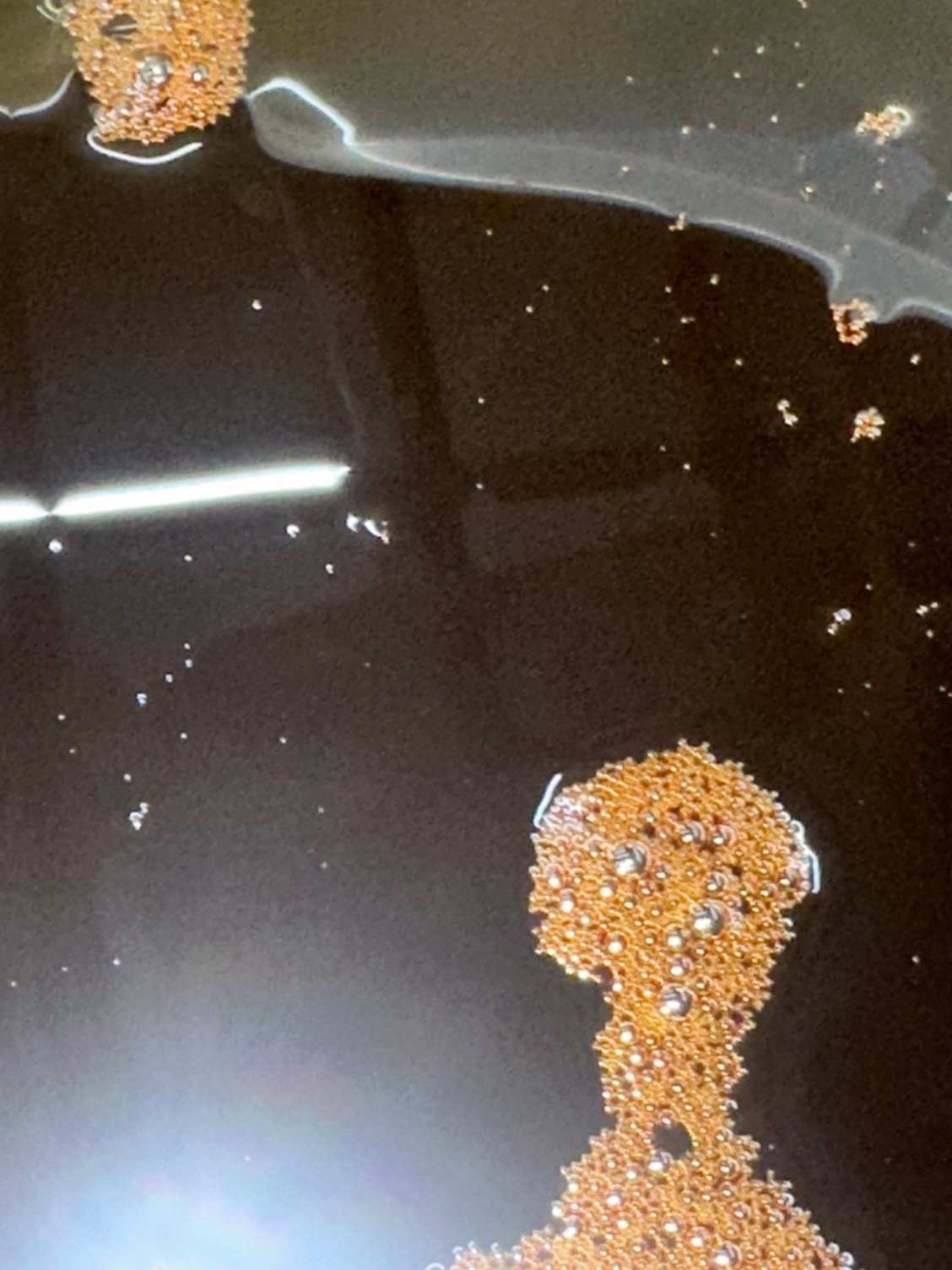

I am a huge believer in the Valvoline Premium restore product. I have used it in all of my cars now one of which is a 2013 LS460 with 133K. It was starting to use a touch of oil at 110k. My recipe was 1 change of Valvoline PBR 5k miles, a change or two of the Valvoline R&P 5w-30 (5k miles) another round of Valvoline PBR and the last fill was 5w-30 Valvoline R&P. Changed to oil today and I am very happy to say it had 0 oil consumption in 4-5k miles. I will say the oil was BLACK today at 4,500 miles…. The filter was clean with no shiny particales nor any black carbon particles. I think I am going to change it at 2,500 miles (oil only) to see how dirty the oil is.
