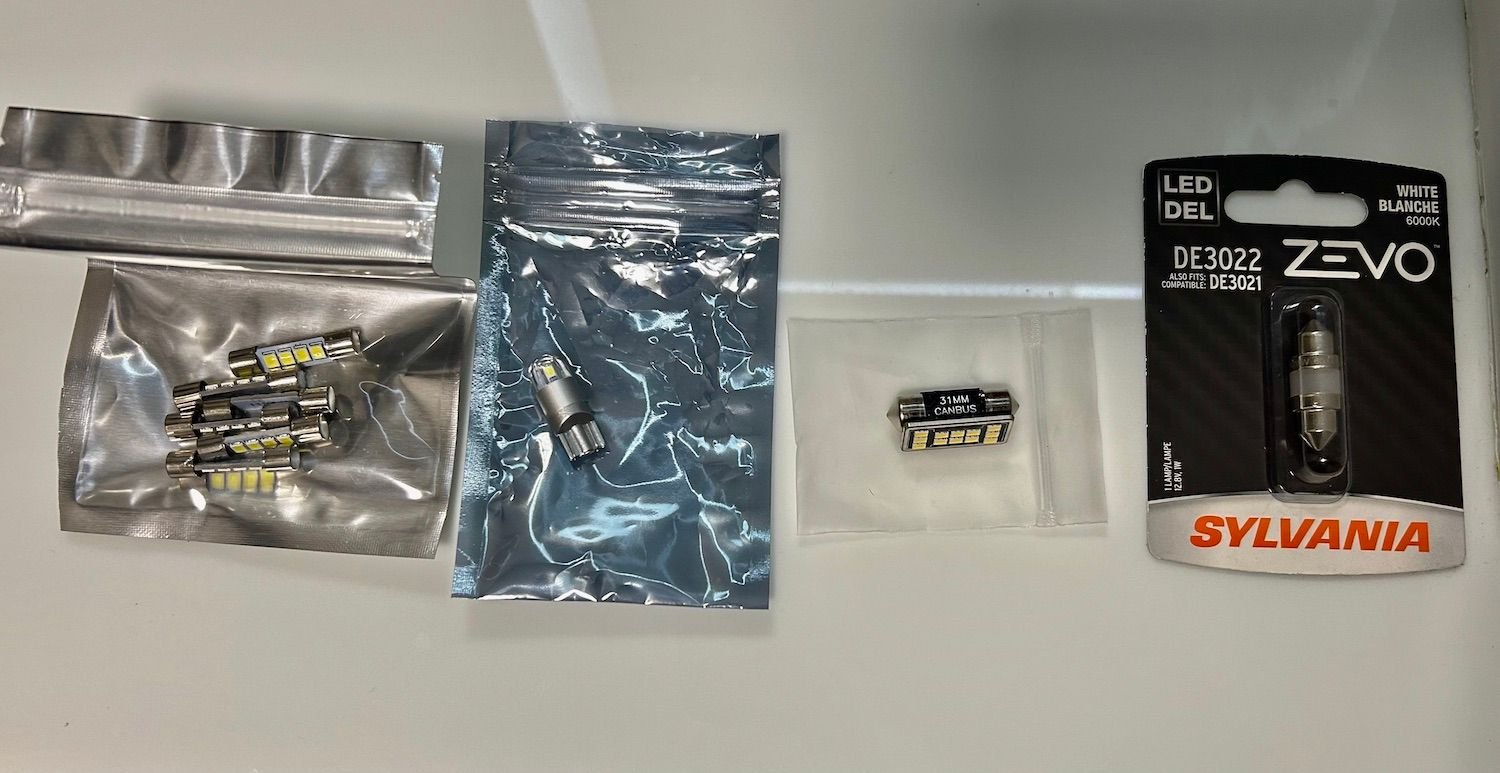

These are what I used for mine, you will need a few of each type and some need specific polarity. You need a "very" thin small flat screwdriver or your gonna scratch the crap out of the covers.

It's a huge difference, I would recommend leaving the covers all off until you get the level of light you want. Every light is on in this picture and you can see the rear seat colour is almost gone because the 2 vanity lights there have 3 bulbs each. I bought all 6k bulbs so a person could go with a lower output like 4300 or 5000, there are about 12 bulbs that you can change.
