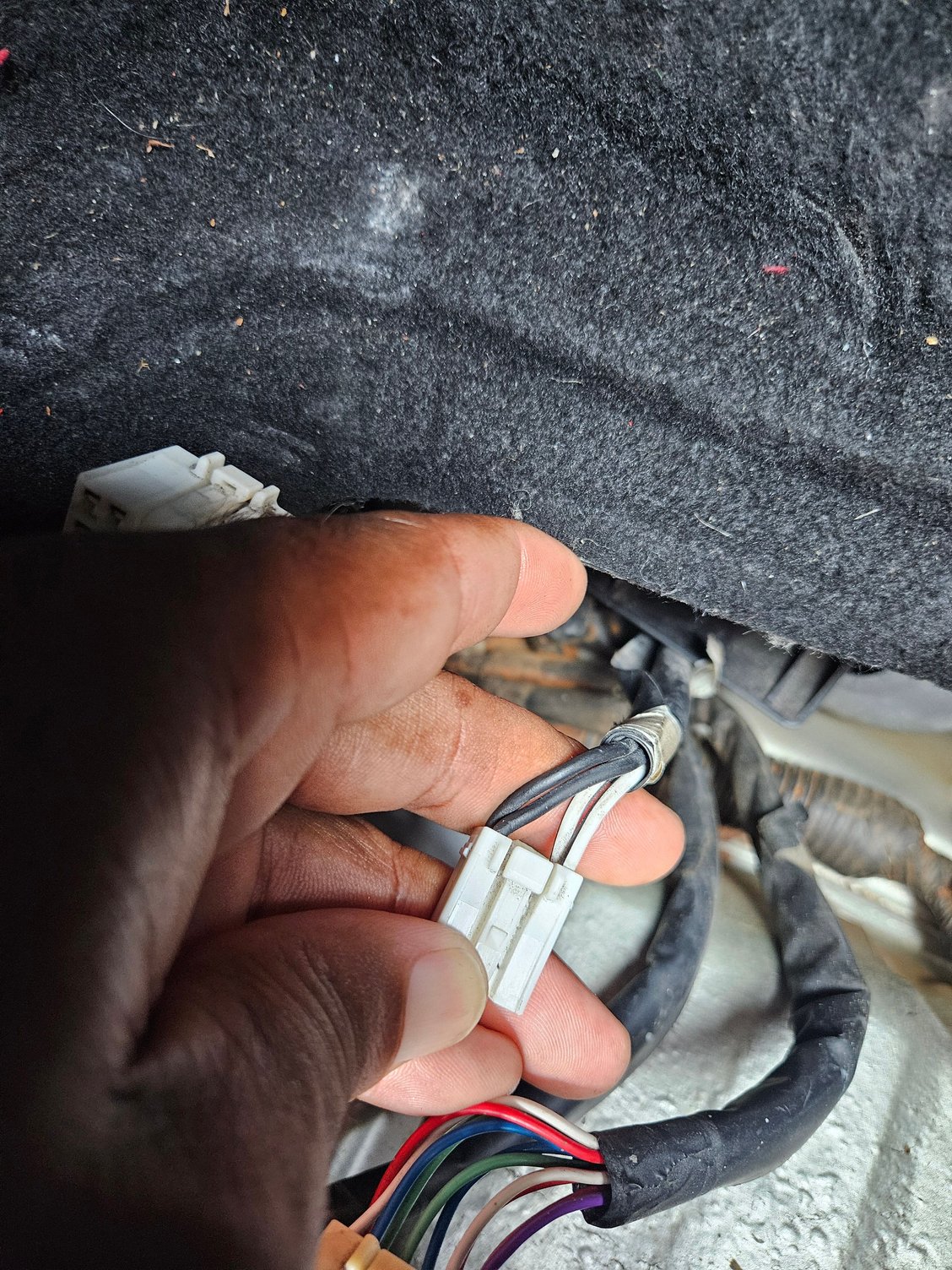

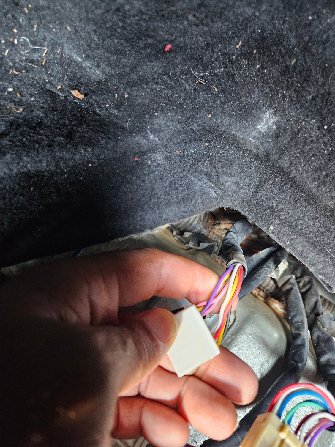

Good afternoon, ladies and gentlemen of CL!! I have a 2009 Lexus LS 460 and I am trying to get power to my amp I have done he test light to all these fuses, and wires to the amp. I have come up with that I have remote power from the blue wire but I have no constant power in from the wires at all. I am wanting to know which wires would be my constant and where is the power coming from? IE fuse, module or what. Any help would be greatly appreciated because this is killing me, riding with out music!!!
This is the blue wire I am getting power from and nowhere else is there power coming in.

I am trying to get power to my amp. I'm not getting power to the amp. I have checked the fuses and checked the wires going to the amp but the only power I'm getting is from the blue wire I stated in the 3rd Pic.

Ground wires are white with black stripe wires in your first picture.
