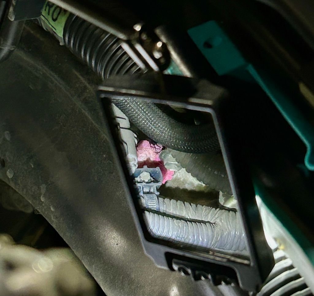

I have a 2013 LS with 32k miles, mine is crusting up in one spot and slowly getting larger but no fluid yet. I will do it some weekend this summer because I can smell antifreeze every time I use but the level isn't going down much...yet.

My 14's heat exchanger was just re-sealed at 84k. I have a borescope and will keep an eye on it since it has a 1 year warranty from Lexus.
