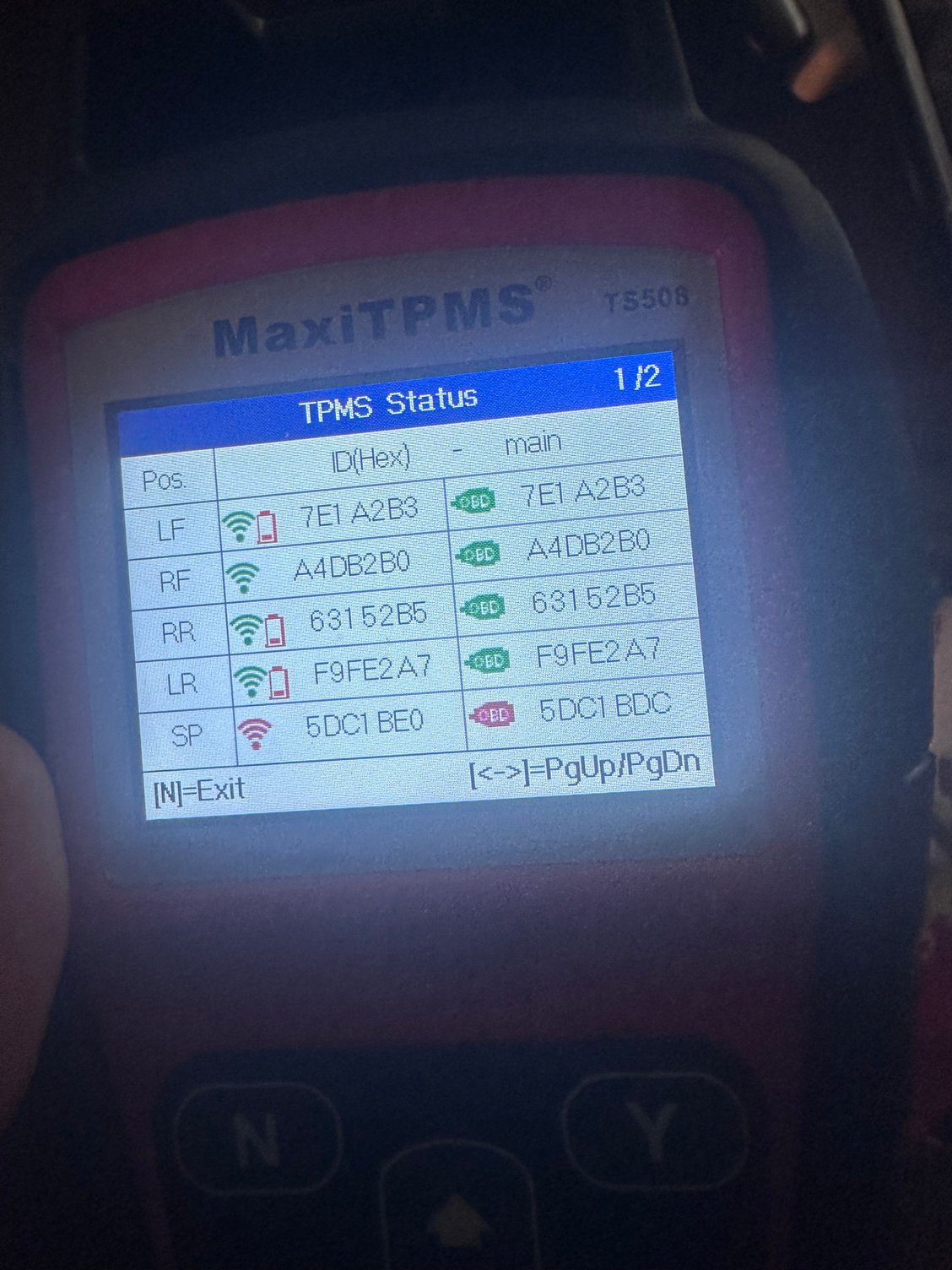

why the code don’t match. What to do.? Spare tire doesn’t read sometimes. It just messes up and light keep on.

Your spare tire TPMS is not registered to your car.

It was registered but after couple of weeks the TPMS sign came back on. I had it done at the shop. It’s not coming up now. I’ll have it replaced soon.

I am going by your screenshot, the tool tells you that the spare tire TPMS is not registered.
