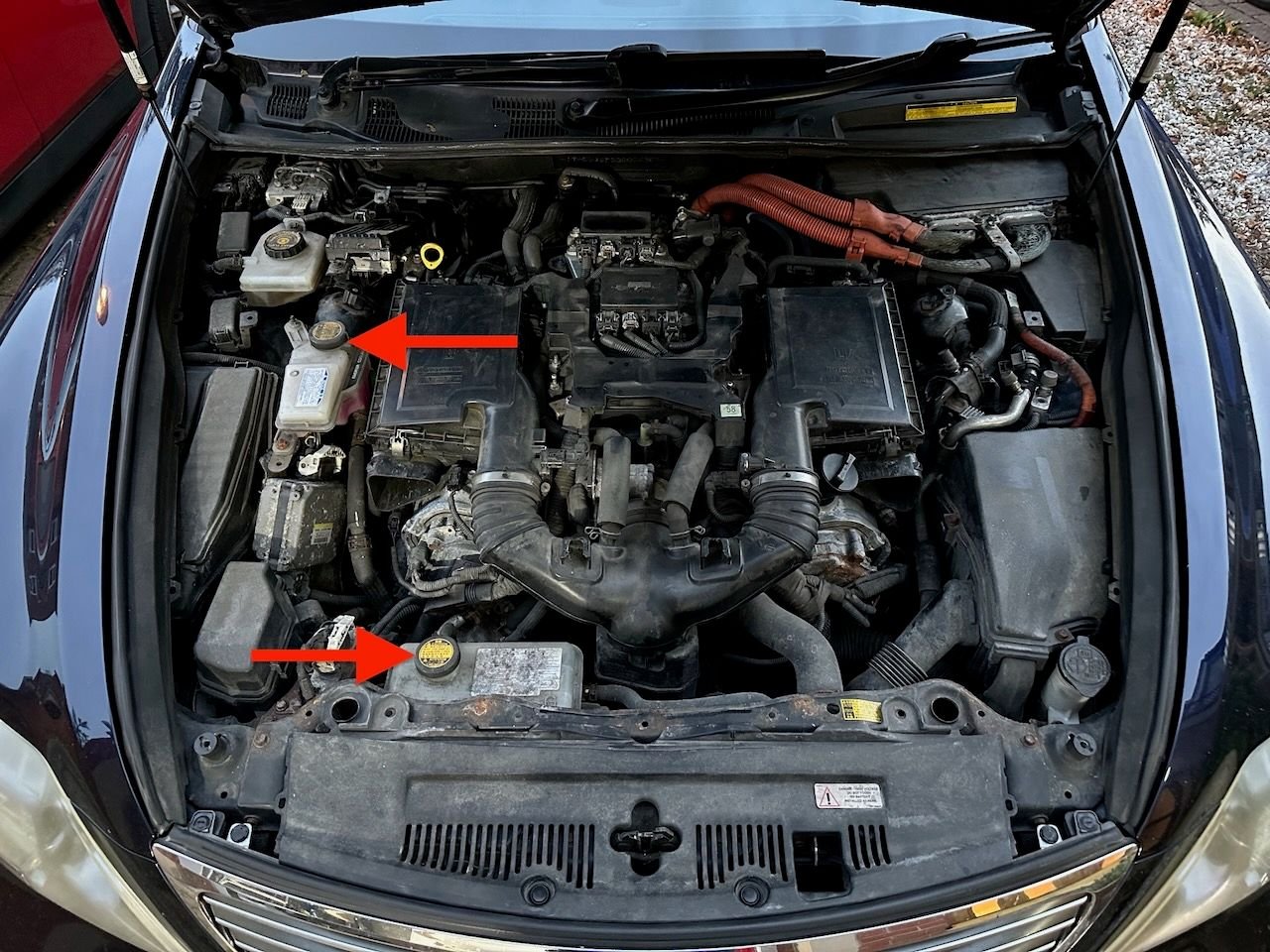

Can someone advise me where the coolant tank is located and accessed
My car is a UK rhd 2010 Ls600hl.

If you took an imaginary line between the top centre of the radiator and the engine, it's just to the right of that (the left as you look at it), under the front plastic piece. There's a rectangular hole in that top piece that you can look through, with a torch, to see the level.
The coolant tank for the hybrid inverter is a bit further back, approximately above the right front wheel.
RHD LS600h coolant tank locations with engine covers removed

Thank you, just need to take off plastic cover then

Thanks guys, very easy, it was the side plastic panel I removed and it was all fine.
