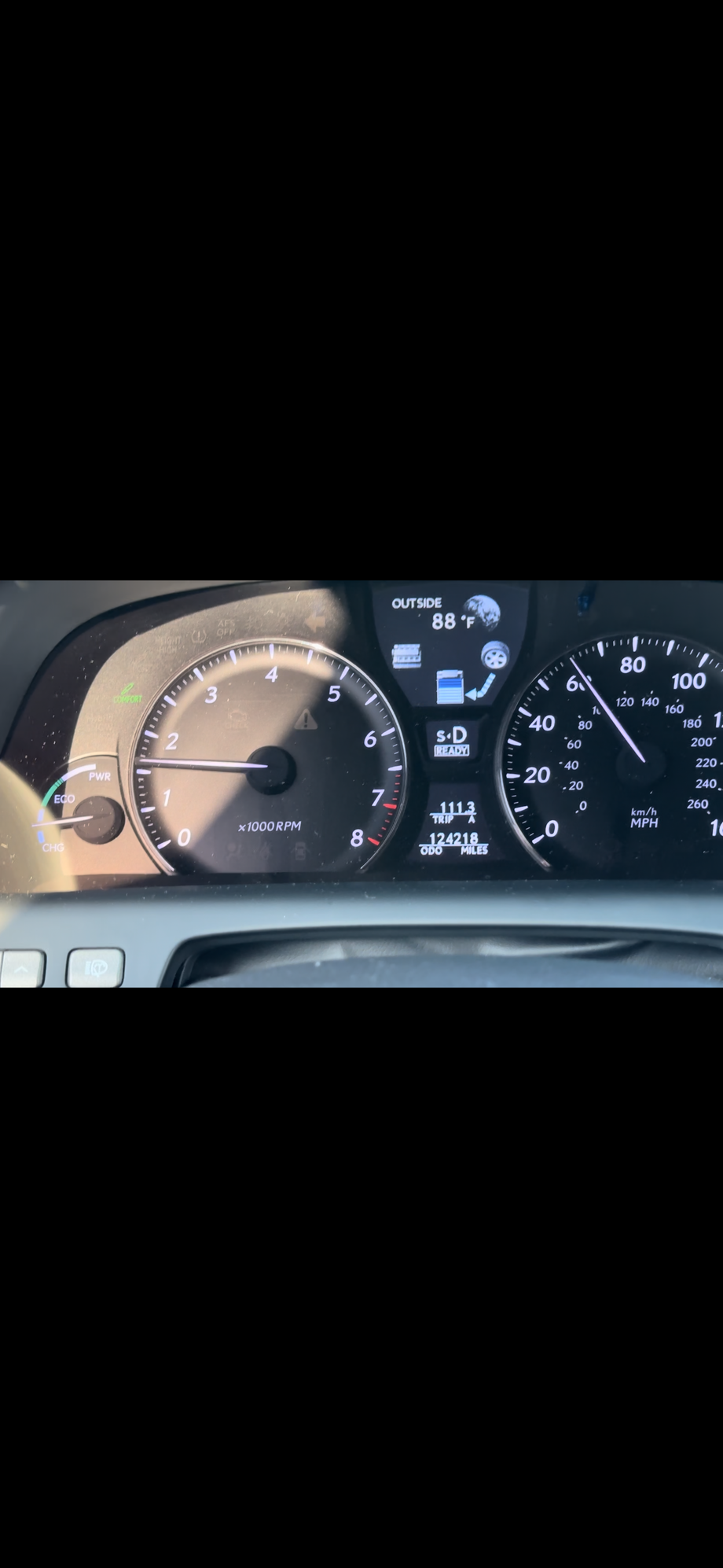

I got no codes showing but the car still behaves like this. As you can see in the pic when the car was regenerate the rev idle will go up to somewhat 1600rpm.

This would normally happen when the battery is full, so the excess energy will be burned by MG1 revving the ICE. Here the battery is not full so I think in this case for some reason the battery is not able to receive all the energy so my first thought would be that the battery is hot. Please check the battery fan and the mesh.
Can you post a longer video, like 2 to 3 minute long?
Also, it would be great if you have Techstream or Dr. Prius so I can see the battery temperature while driving.
