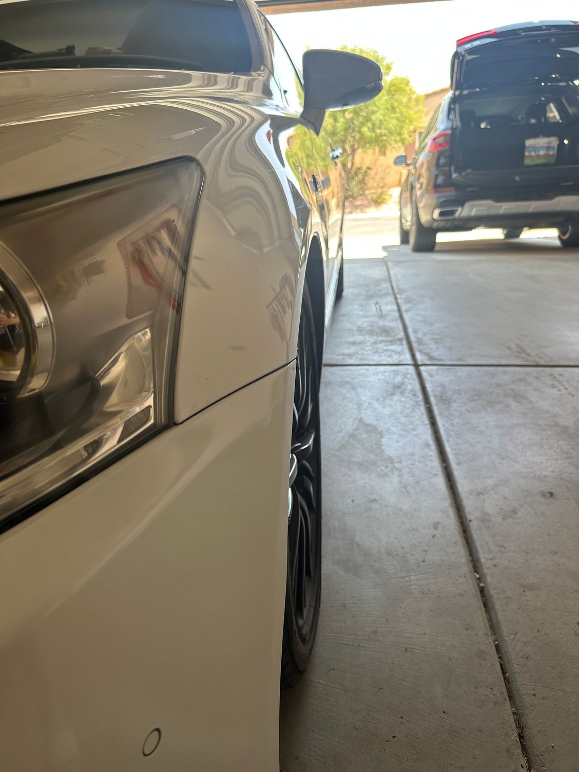

Thanks @Gerf , I’ll check them out. @dubsta1 , personally I just want some 15mm spacers for the rear to even them out with the front. After measuring wheel to fender there is a difference of about a half inch. I have 22x9 Vossens w/ a +32 offset all around and notice the fronts are more flush with fender than the rears.
Kind of hard to notice in this pic. I will post another pic after spacer.

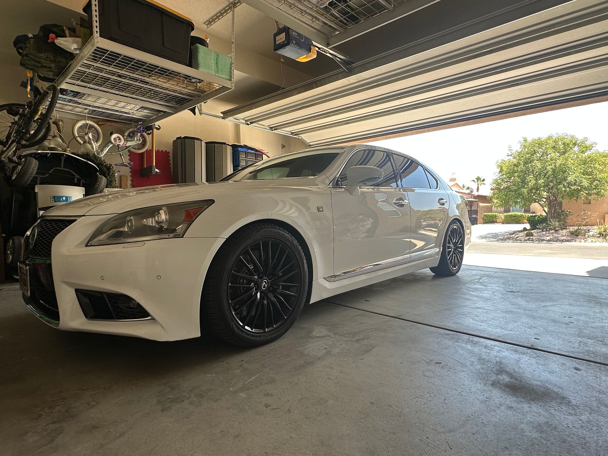

Received my spacers after 3 weeks, as they’re made to order in Reno, NV USA!
Went with @Gerf rec, & ordered 4 20mm type 3 spacers from Motorsport tech. Link is on the 2nd post.
They’re 100% plug n play with 2013 f sport 19” wheels. Zero modifications needed.
I have a data system controller & ride on level 3 all around. The spacers def compliment a lowered ride.
IMO, if you’re riding on stock wheels stock height, these are NOT necessary.
anyhow, took about 2 hours using the oem floor Jack in my garage, in sweltering 120F.

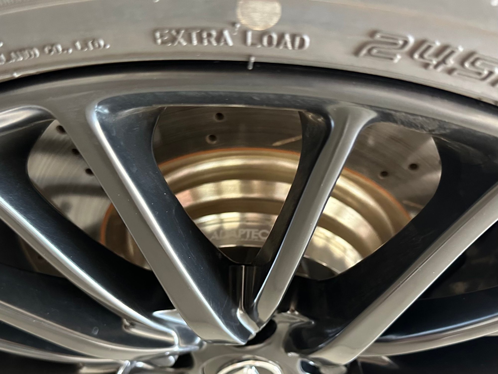

I don't remember if I asked this before but what finish is on your wheels, I like that blacked out look.
Have to ask, in the last picture the spacer nut at 10 o'clock doesn't look like it's on as many threads as the rest and there seems to be a gap on the right hand side of all the nuts...maybe I'm seeing things.

Wheels are powder coated semi gloss black. The shop owner said full gloss would show scratches the first time it’s wiped w/ a dirty rag.
Keen eye, sir. Lol. I was in the process of hand tightening nuts, sweat dripping in my eyes and all, & decided I should take a quick pic.
